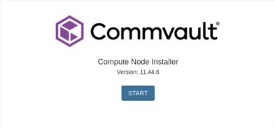

    # hssetup
    The Commvault Flex Open Installer page appears.
    flex_open_install1
  3. Click Start.

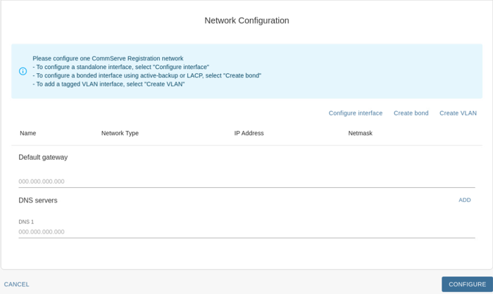

    flex_open_network_configuration

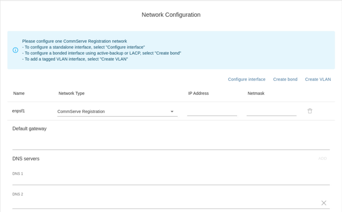

  4. Configure the interface as follows:
    1. Click Configure interface.
    2. From the Interfaces list, select the network interfaces that you want to configure.
    3. Click CREATE.
    flex_open_network_configuration_basic2
  5. From the Network Type list, select CommServe Registration.
  6. Add the IP Address and Netmask in the respective boxes.
  7. Configure the DNS server(s) as follows:
  8. Click CONFIGURE.
    flex_open_network_configuration_basic3

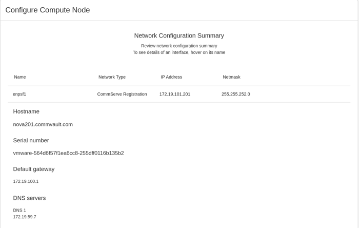

  9. Verify the network configuration and then click CONTINUE.
    • IP address and netmask for the CommsServe Registration interface is accurate.

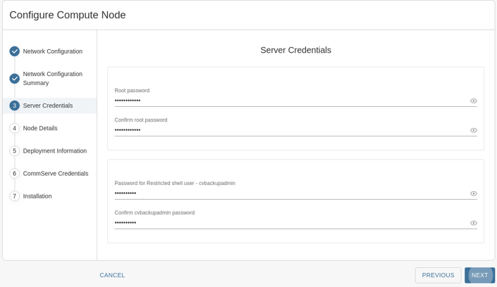

    flex_open_server_credentials
  10. Add the following information:
    2. In the Password for Restricted shell user - cvbackupadmin and Confirm cvbckupadmin password boxes, type a secure password for the cvbackupadmin user.
    3. Click NEXT.

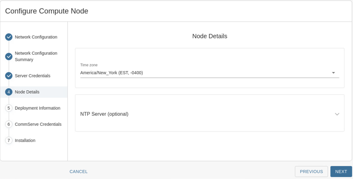

  11. Add the following information:
    1. From the Time zone list, select the time zone in which the nodes are located.
    2. Optional: In the NTP Server/Pool box, type the IP address of the NTP server or NTP pool if available.
    3. Click NEXT.

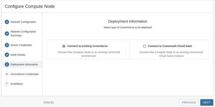

  13. To connect to an exsiting CommServe, complete the following steps:
    1. Select Connect to existing CommServe and click NEXT.
      The CommServe Credentials page appears.

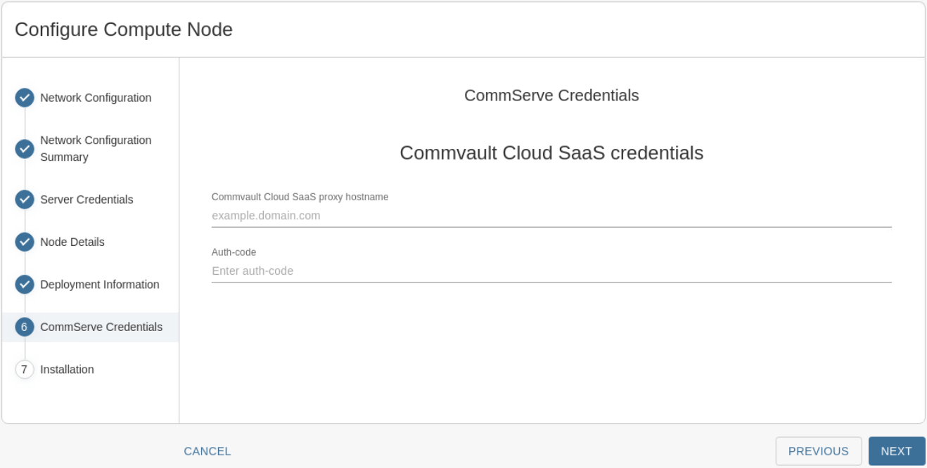

  14. To connect to an exsiting Commvault Cloud SaaS instance, on the Deployment Information page, complete the following steps:
    1. Select Connect to Commvault Cloud SaaS, and then click NEXT.
    2. Add the following information:
      1. In the Commvault Cloud SaaS proxy hostname box, enter a fully qualified host name of the SaaS instance that you are connecting to.
      2. In the Auth-code box, enter the authorization code to connect to the instance.
      3. Click NEXT.
