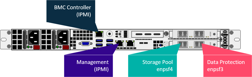

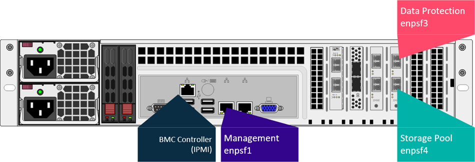

Cabling and Cable Connections
Connect the 10 GbE data protection port from each node to the data protection network.
All data management tasks including backups and restores, are established through the 10GbE data protection ports.
Connect the 10 GbE storage pool port from each node to the private storage pool network.
All storage related tasks, including all cluster connectivity for the storage pool network, will be through this 10GbE storage pool port.
Connect the 1 GbE IPMI port (BMC Controller) from each node to the IPMI or management or utility network for lights out access.
Connect the 1 GbE management port to the management network.
All management related activities, such as connecting to the CommServe server, accessing the DNS server, etc. will be established through the management port.
HS4300 Connections
HS2300 Connections

2x 1 GbE network cables for the iRMC port and management ports
2x 10 GbE network cables for the data protection and storage pool ports
6x 1 GbE network cables for the iRMC and management ports
6x 10 GbE network cables for the data protection and storage pool ports
