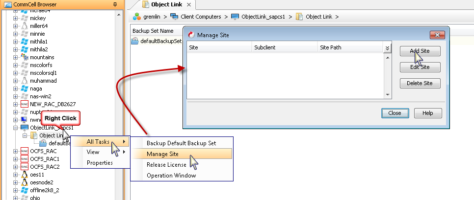

Creating a Site
From the CommCell Browser, expand Client Computers >SAP Archive Link Client .
Right-click the Agent andpoint to All Tasks > Manage Site
The Manage Site dialog box appears with the following information:
Site: Displays the name of the site
Subclient: Displays the name of the subclient associated with this site
Site Path: Displays the URL or path to the site
Click the Add Site button to define a content repository.
From the Add Site dialog Box, enter the following information, and then click OK.
Site Path: Enter the directory path of the site. This is the repository on the server where the files will be uploaded. Note that the URL must be entered in the following format: /finance_site1.
A forward slash "/" is required while entering the site path.
Site Name: Enter the friendly name for the site.
Security XML: is required for the site that is created. Below is an illustration for SAP:
<?xml version=\"1.0\" ?><SapCS_SAPCSDocHeader docStatus=\"running\" boundary=\"test Content Repository\" docProt=\"crud\"></SapCS_SAPCSDocHeader>
In the XML string above:
The docStatus must always be in the "running" mode.
The boundary can be any valid string so that the xml format is fixed. For example: "test content repository".
The docProt value can be a blank string, c, r, u, d or any combination of 'crud'.
External Identification: Enter the third party identifier here.
Retention Days: Specify the retention period for the site. The retention period will apply to all the contents within the repository. Note: Storage policy retention settings are not applicable for this site.
Subclient: Displays a list of the available subclients, select the one to be associated with this site. The site will be added in the selected subclient.
To verify if the site you added is displayed, go to the Path windowpane of the Subclient Properties - Content tab, and then click OK.
The SAP Archive Link subclient is linked to the defined site as the repository.
