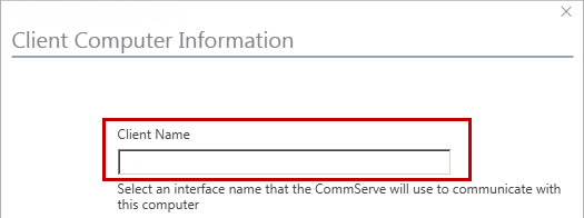

Later on the installation, on the Client Computer Information page, make sure that you provide the name of the old CommServe computer.
