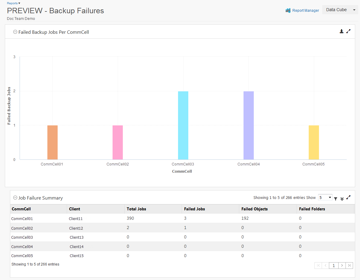

  9. Click Preview to see what the report will look like.
    custom_report_example
