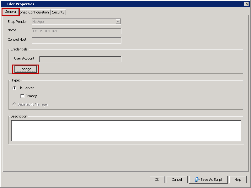

What account types and roles should I set for the Cluster Mode operating system?
Add a user in the Array Management credentials with ontapi and ssh roles. Add the cluster in Array Management and then SVMs are detected and added from the cluster client.

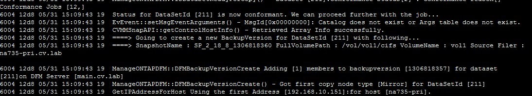

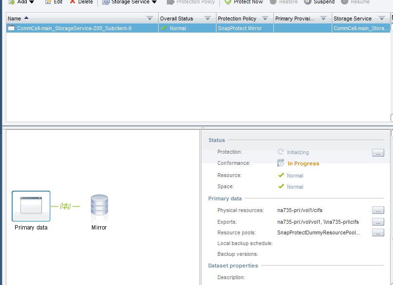

How does the SnapMirror process work?
  1. To get the full, detailed Snap Management plan so that SnapMirror/SnapVault can run, NetApp runs a conformation check during the first auxiliary copy job.
    • On NetApp
      conformation_check

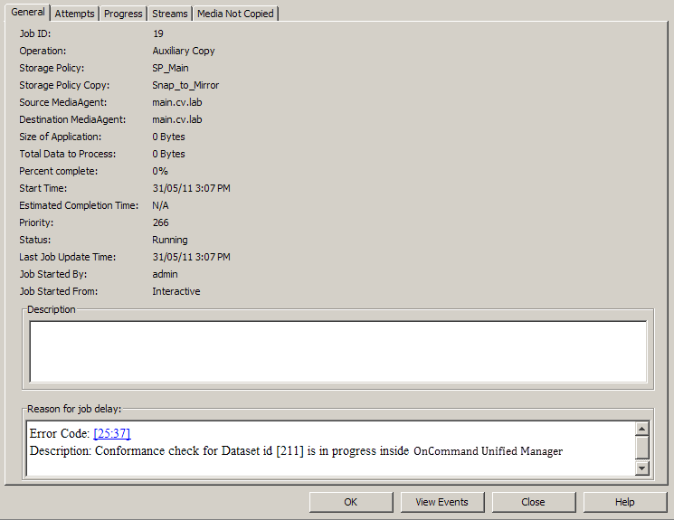

    • On Commvault
      aux_copy_details

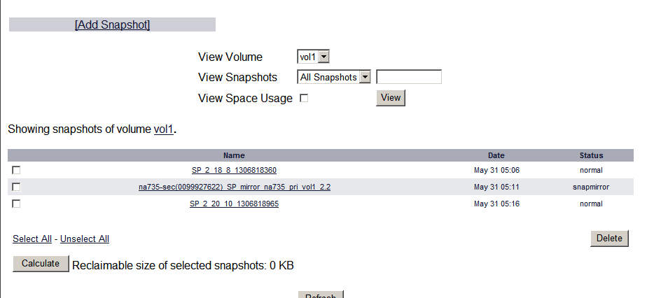

  2. During each SnapMirror auxiliary copy job, SnapMirror creates a “BackupVersion," which is a new Snapshot of the entire volume that requires replication.
    backup_version

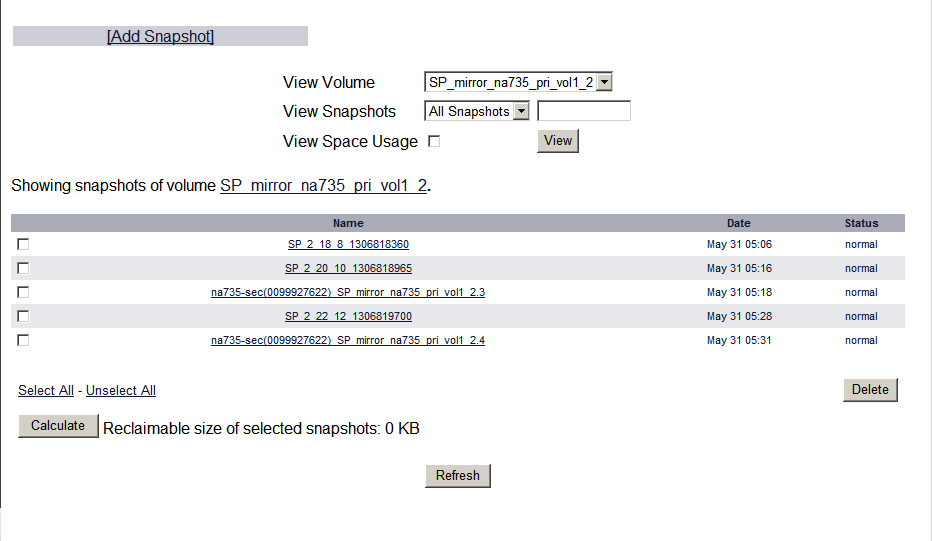

  3. Once a new Snapshot for SnapMirror is available, the Snapshot is listed under the volume on the Primary Filer.
    primary_filer_vol

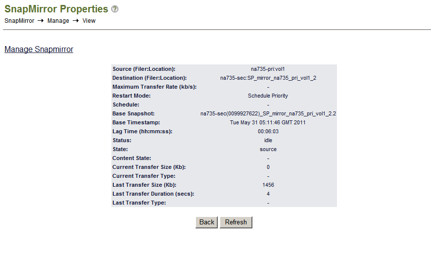

  4. The new Snapshot also appears in the current SnapMirror session.
    snapmirror_session
  5. On the destination filer site, the same Snapshot appears. In addition, if there were any previous SnapMirror on-demand jobs run, only the very last one remains on the target box.
    NetApp calls this a “Swizzling Process”. That is, the primary Fabric-Attached Storage (FAS) creates a delta set between the original snapshot used from the previous SnapMirror job and the new snapshot created for the current SnapMirror job. Only the details of the snapshot and the deltas are sent to the destination FAS, and refer to the previous snapshot, which was formerly the target SnapMirror session. The volume is updated to match what is in the primary FAS. The previous snapshot is not deleted because the entire process is a background job.
    destination_filer_vol

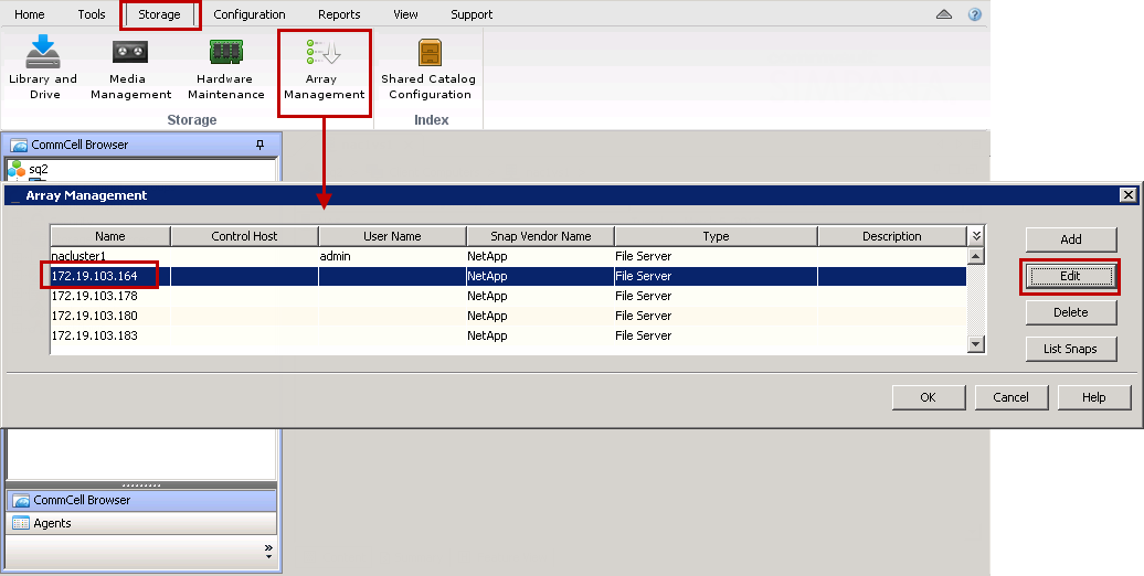

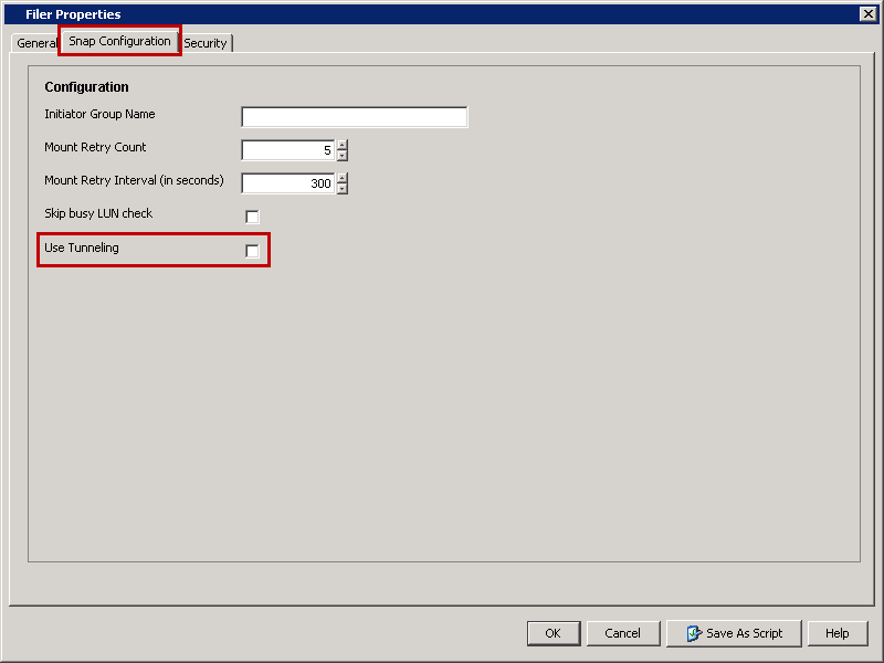

Can I disable tunneling for a storage virtual machine?
Yes. If you want to disassociate a particular Storage Virtual Machine from a NetApp array, then you can turn off the tunneling option.
All jobs scheduled through the array no longer run for the disassociated Storage Virtual Machine.
To turn off tunneling:
  1. Log into CommCell Console.
  2. Click the Storage tab, and then click Array Management.
  3. Select the Storage Virtual Machine for which you want to turn tunneling off, and then click Edit.
    array_mgmt_button
  4. Click the Snap Configuration tab, clear Use Tunneling, and then click OK.
    tunneling_disable
  5. Click the General tab, and then under Credentials, click Change.
    tunneling_change_pswd
  6. In the User Name and Password boxes, enter the NDMP credentials, and then click OK.
    tunneling_ndmp_creds
  7. Click OK to close the Filer Properties dialog box.
  8. Click OK to close the Array Management dialog box.
