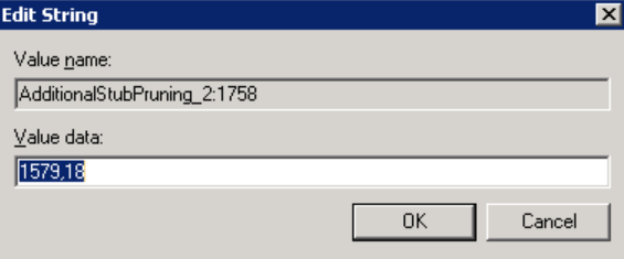

Example of Pruning Migrated Stubs
Stubs archived by SubclientID 1579 and SubclientID 18 are moved to SubclientID 1758. Create the AdditionalStubPruning_<CommCellId>:<CurrentSCId> additional setting and set the value as follows:
embd_Pruning_Migrated_Stubs
where:
  • AdditionalStubPruning_2:1758 = name of the additional setting
  • 2 = CommCell ID of the CommCell Console
  • 1758 = subclient ID of the subclient that contains data of subclient 1579 and subclient 18 that must be pruned
  • 1579 and 18 = the IDs of subclients whose data is moved to subclient 1758
