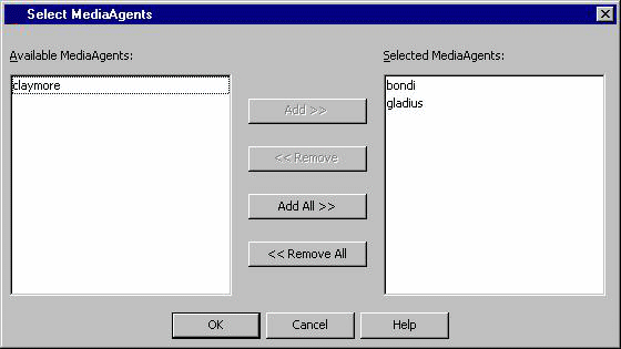

In the Select MediaAgents dialog box, select the name of any one MediaAgent that will share the library.

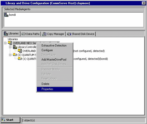

Detect the devices. Use Device Detection as required.
If the library supports SCSI 3 drive identification, it is not necessary to perform an exhaustive detection.
The library and all drives are displayed for the MediaAgent that is connected to the SAN in the Expert Storage Configuration window.
For a Solaris MediaAgent in the SAN environment, the operation will fail to detect devices with SCSI target higher than 15 and/or LUN higher than 7. In a such a situation additional entries must be added for such devices in the wa.conf file. For information on adding these entries see Add Additional Entries in wa.conf File in the Solaris MediaAgent.
If any additional drives are visible on any of the MediaAgents due to incorrect zoning you must do one of the following:
Correct the zoning and restart the configuration process.
Delete the additional drives before performing the next step.

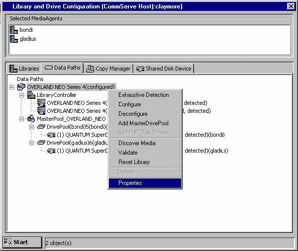

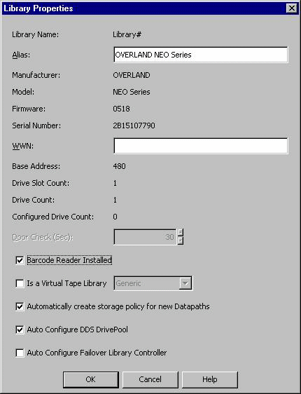

Right-click the library and then click Properties.
From the Library Properties dialog box, select the following option:
- Auto Configure DDS DrivePool: Enable this option to automatically configure the DDS drive pools for MediaAgents sharing these drives.
Optionally, consider the following options and enable or disable it if necessary:
Auto Configure Failover Library Controllers: Enable this option to automatically configure the Failover Library Controllers in all the MediaAgents sharing this library.
Automatically create storage policy for new Datapaths: Enable this option to automatically create a new Storage Policy when the library is configured.

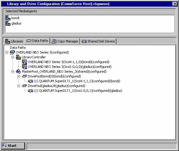

Configure the library as described in Configuring Devices. The library is configured and displayed with the configured, detect success status in the Expert Storage Configuration window.
The Library tab provides the physical view of the devices (library and drives).
The Data Paths tab provides a logical view of the data path used to access the devices - library, master drive pool, drive pool, drive.

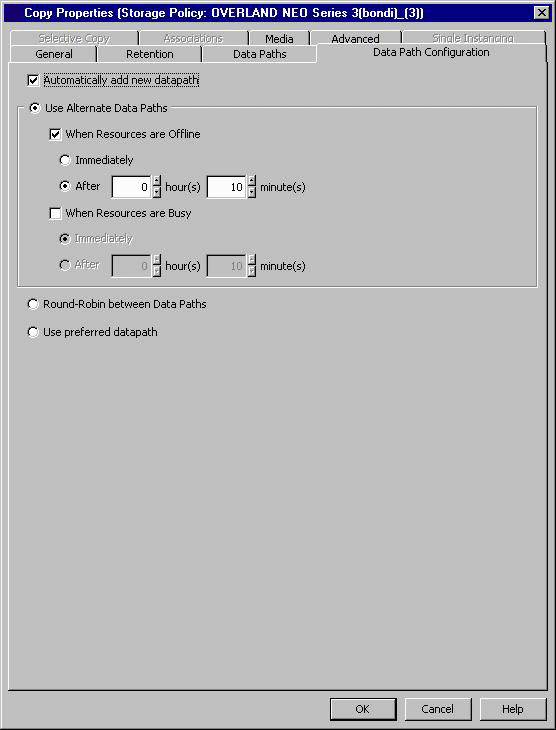

From the CommCell Console, right-click the Storage Policy Copy that was created during the library configuration and then click Properties.
From the Copy Properties dialog box, click the Data Path Configuration tab.
Enable the Automatically add new datapaths option.

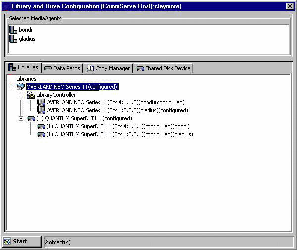

Open the Expert Storage Configuration window and verify that the libraries are configured from all the MediaAgents that share the library.

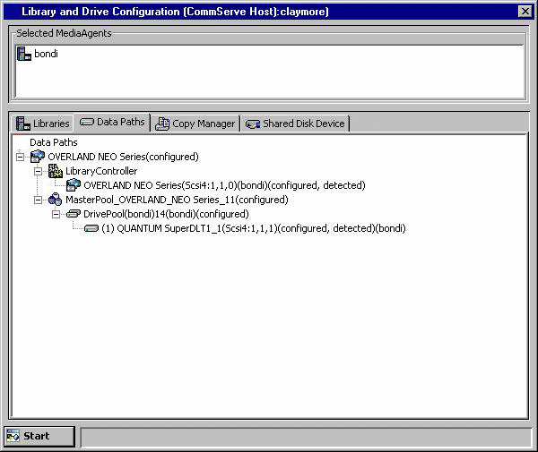

Display the Expert Storage Configuration window.

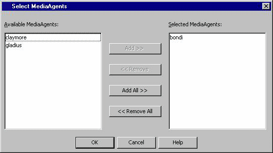

In the Select MediaAgents dialog box, select the name of only one MediaAgent that will share the library.

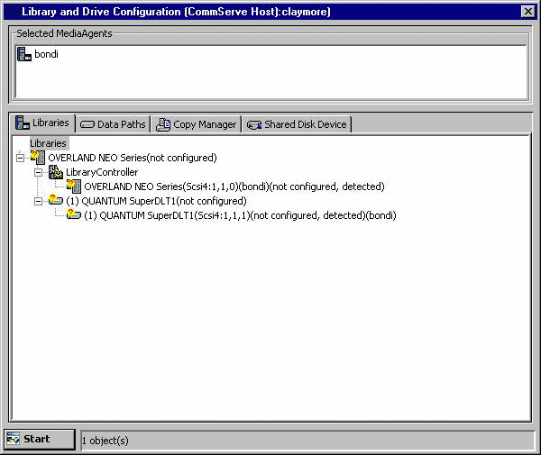

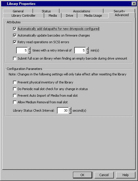

From the CommCell Console, right click the appropriate library and then click Properties.
From the Library Properties dialog box, click the Advanced tab.
Enable the Automatically add datapaths for new drivepools configured option.

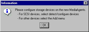

From the Expert Storage Configuration window, click the Start menu and choose Select MediaAgents.
Select the following MediaAgents:
The MediaAgent in which the library is already configured.
Other MediaAgent(s) in which you wish to configure the library using DDS.
Click OK in the Information prompt.

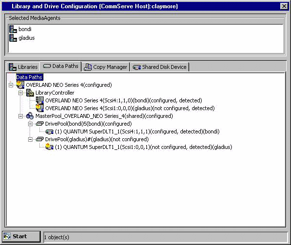

Detect the devices that are controlled by MediaAgents that will access the library as described in Detect Devices.

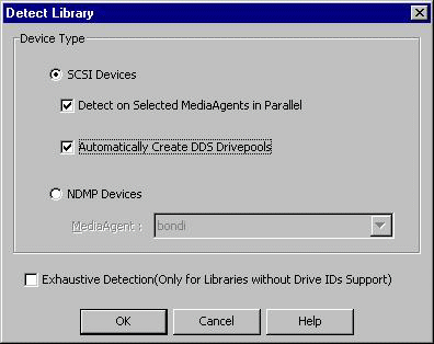

In the Detect Library dialog box, select the following options:
Detect on Selected MediaAgents in Parallel
Automatically create DDS Drivepools
The option to automatically create/configure DDS DrivePools is not available for NAS-attached libraries; Dynamic Drive Sharing must be configured manually. For instructions on how to configure DDS for NAS-attached libraries, see Configure NAS-attached Libraries Shared Across a SAN.
The system detects the drives and automatically displays them with the DDS setup in the Expert Storage Configuration window.

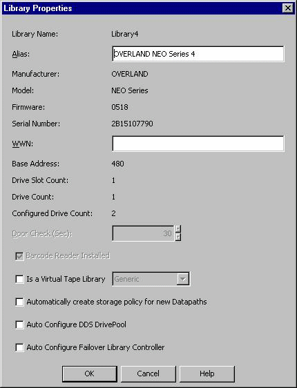

Perform the following steps if you wish to disable the automatic Expert Storage Configuration in such MediaAgents:
From the Expert Storage Configuration window, open the Library Properties dialog box associated with the library you wish to disable automatic configuration.
Disable the following options:

Open the Library Properties dialog box and select the following option:
Optionally, consider the following options:
Automatically create storage policy for new Datapaths: Disable this option for libraries with mixed drive types.
