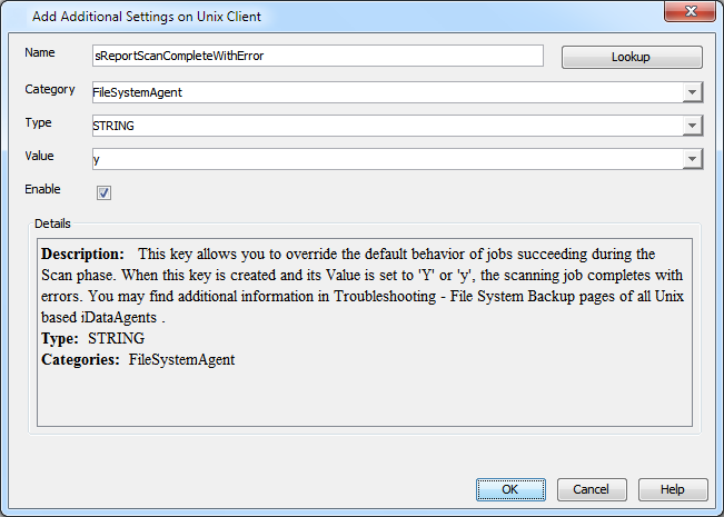

By default the backup jobs from Linux File System iDataAgent complete without any error messages.
In the Scan phase files that cannot be accessed will be populated in scan_failures.cvf, in the following scenarios:
Stat failed.
If a file is deleted or renamed.
Unable to open a directory during scan
To view the "Completed w/ one or more errors" message in the Job History in the Scan phase, follow the steps given below:
From the CommCell Browser, navigate to Client Computers.
Right-click the <Client> and click Properties.
Click Advanced and then click Additional Settings tab.
Click Add.
In the Name field, type sReportScanCompleteWithError.
In the Value field, type y or Y to enable the error message display or n or N to disable the error message display..

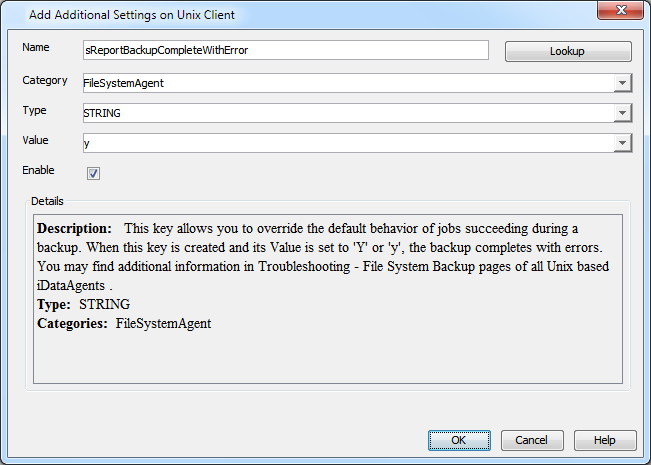

During backups the jobs will be marked partial success and reported into Failures.cvf, in the following scenarios:
Stat failure on a backup file (moved/accessed, etc).
Unable to open a directory.
Error to get the file attributes.
If File is locked.
Path is a symbolic link and you are unable to read the symbolic link path.
Critical error while reading extended attributes or ACLs of the file or directory.
Size of the extended attributes or ACLs buffer exceeded the backup buffer size (default pipeline buffer size is 63kb).
To view the "Completed w/ one or more errors" message in the Job History after a backup, follow the steps given below:
Click Add.
In the Name field, type sReportBackupCompleteWithError.

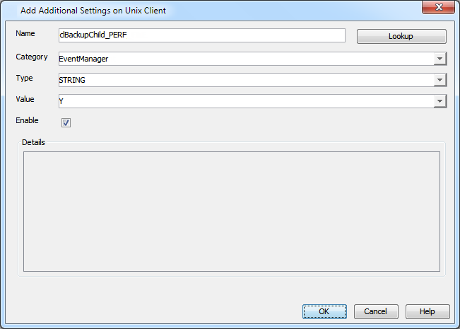

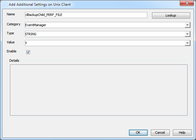

Troubleshooting Performance Issues
If you are experiencing performance issues during backup, you can troubleshoot them by enabling logging of performance details in the log files. These performance counters contain information that help in resolving the performance related issues during backups.
The performance counters printed in the log files include:
FileRead |
Average time spent in system call to read the file. |
CheckFileHole |
Average time spent to verify if buffer read from the disk is a hole. |
Close File |
Average time spent in system call to close the file. |

Displaying Performance Details of a Backup Job
Click Add.
In the Name field, type clBackupChild_PERF.
In the Value field, type Y.
Displaying Performance Details for Each File in a Backup Job
In addition to viewing the performance details for a backup job, you can also view the performance details of each file in the backup job. Note that the file names are not printed in the log.
Click Add.
In the Name field, type clBackupChild_PERF_FILE.
This additional setting should be used together with the clBackupChild_PERF additional setting.
