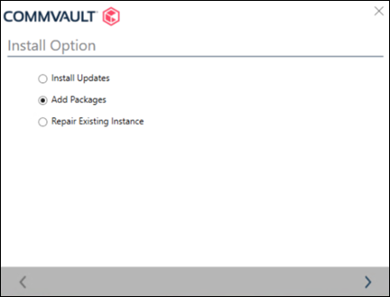

Run the latest installer of the installed Commvault feature release on the same hardware. For more information, see Installing Commvault Locally Using the Download Manager.
During the installation procedure, select the same Commvault instance, and then select Add Packages on the Install Option page, as follows:
Select the same Commvault database packages that were selectively removed in Step 3, above.

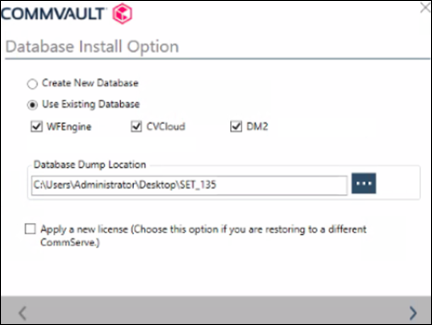

On the Database Install Option page (see below), select Use Existing Database, and then select the database packages that you added and that you performed a .dmp database backup for in Step 2, above.
On the Database Install Option page (see above), in Database Dump Location, enter the location of the .dmp database backup file that was created in Step 2, above. This DR backup file is automatically upgraded if necessary.
Click Next.
