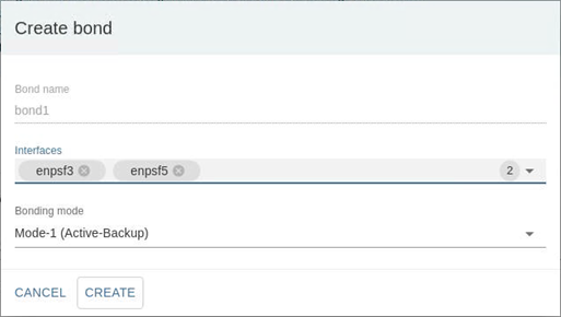

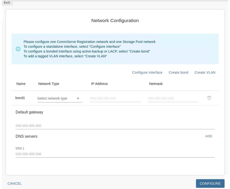

  3. Create a data protection interface bond as follows:
    1. Click Create bond.
      Tagged vLAN and Bonding (30)
    2. From the Interfaces list, select the data protection interfaces. (enpsf3 or enpsf5)
    3. From Bonding mode list, select either active-backup (Mode 1) or LACP (Mode 4).
    4. Click CREATE.

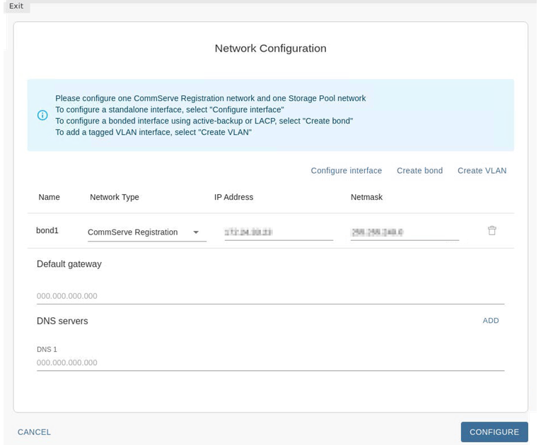

    5. From the Network Type list, select CommServe Registration
    6. Add the IP Address and Netmask in the respective boxes.

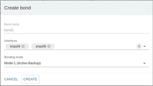

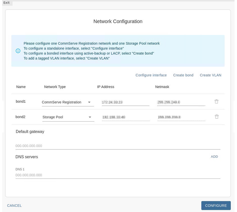

  4. Configure the storage pool interface (bonded) as follows:
      Tagged vLAN and Bonding (31)
    2. From the Interfaces list, select the 2 interfaces that will form the storage pool bond. (For example, enpsf4 and enpsf6 .)
    4. Click CREATE.

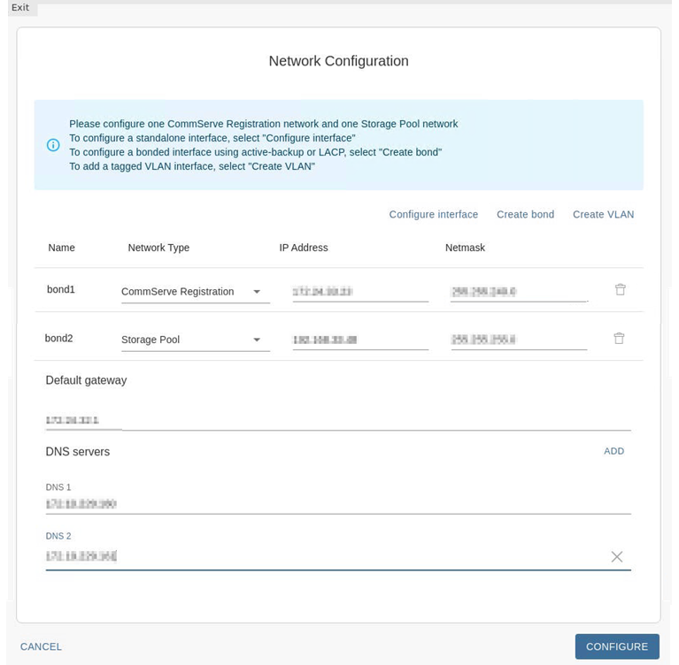

    5. From the Network Type list, select Storage Pool. This interface will be be used exclusively for communication and replication between the HyperScale nodes.
      LACP Bonding (2)

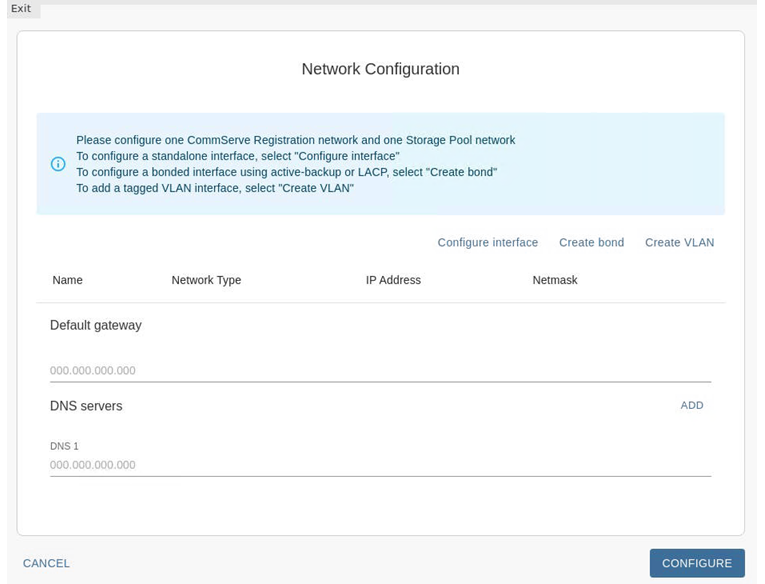

  5. Configure the DNS server(s) as follows:
      LACP Bonding (3)
    3. Click CONFIGURE.
      LACP Bonding (7)

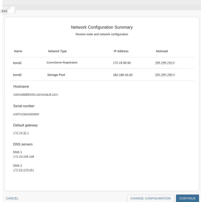

  6. Verify the network configuration and then click CONTINUE. Verify the following information.
    • IP address and netmask for the data protection interface is accurate.
    Tagged VLAN (7)
  7. Click one of the following:

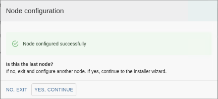

      Repeat the steps (step 1 through 6) from another node.
      The Setup Type page appears.

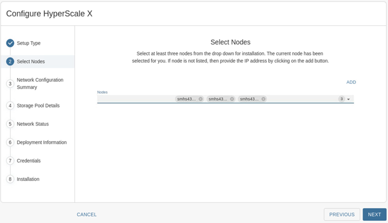

  9. Select the nodes as follows:
      You can select up to 12 nodes at a time for the initial deployment. Nodes are listed by serial number. If one or more nodes are missing from the list, there is likely a cabling or network configuration issue. To troubleshoot, see Troubleshooting Network Configuration Errors.
    3. Click NEXT.
      Tagged vLAN and Bonding (28)
    4. Click NEXT.

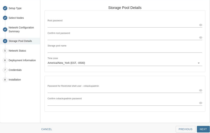

  11. Add the following information:
    5. Click NEXT.

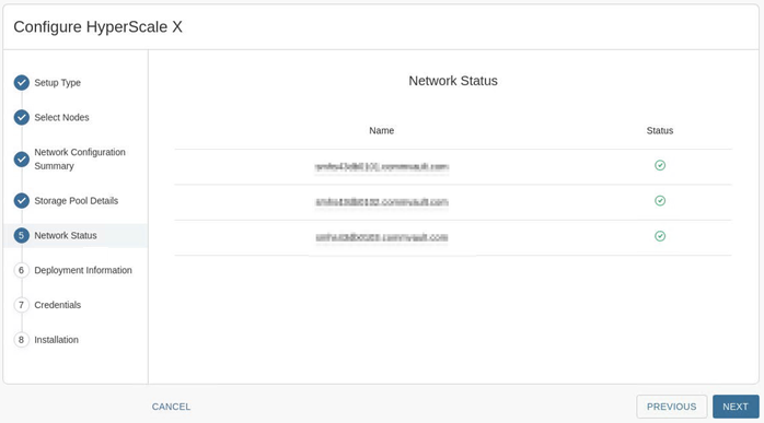

  12. Check the status to ensure that all the nodes have a green status to indicate that the network settings is validated and accurate. Click NEXT.

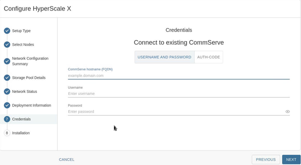

  13. Click Connect to existing CommServe, and then click NEXT.
    The Credentials page appears.

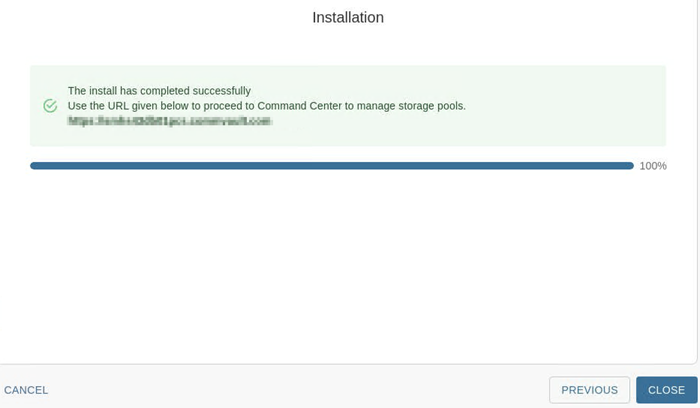

  14. Choose one of the following options to connect to the CommServe:
        Connecting to an Existing CommServe Server (1) The software validates the information and will start the installation process. This process may take some time (approximately 45 minutes) to complete. You can monitor the progress using the progress bar.
    embd_SetupCS2 (1)
  15. Click CLOSE.
