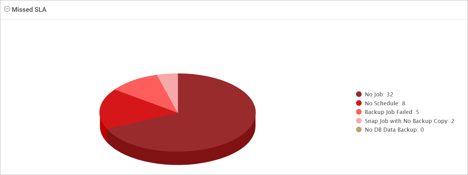

Missed SLA Chart
The Missed SLA chart displays the number of servers that missed the SLA threshold for each reason that backup jobs did not run.
missed_sla_chart
To view this report, in the SLA Server Summary chart, click Missed SLA.
