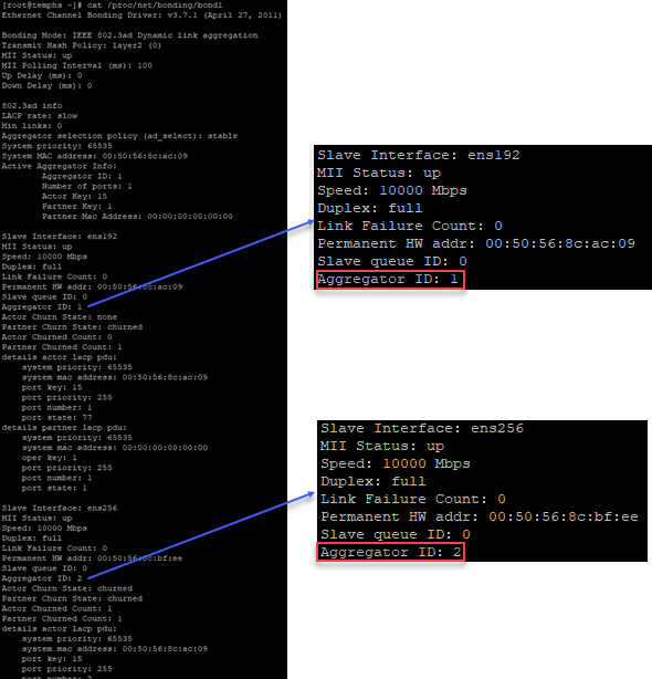

    You should see an output similar to the one shown in the following image:
    Verifying LACP Bonding Configuration (2)
    The key detail is the Aggregator ID of each child interface. If this does not match between the two child interfaces, it indicates a cabling or configuration issue that your Network Administrator has to diagnose and resolve. It cannot be resolved from the appliance.
