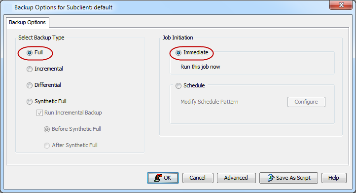

Full Backups
  1. Full backups provide the most comprehensive protection of data. From the CommCell Browser, navigate to <Client> | Proxy Client File System | <Backup Set>.
  2. Right click the <Subclient>, and then click Backup.
  3. Select Full as backup type and Immediate to run the job immediately.
  4. Click OK.

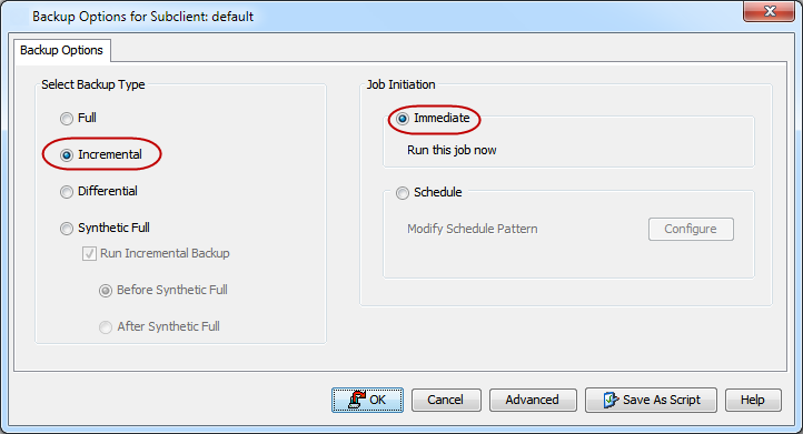

Follow the steps below to perform an incremental backup:
  1. From the CommCell Browser, navigate to <Client> | Proxy Client File System | <Backup Set>.
  3. Select Incremental as backup type and Immediate to run the job immediately.
  4. Click OK.

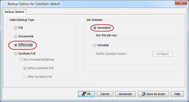

Follow the steps below to perform a differential backup:
  3. Select Differential as backup type and Immediate to run the job immediately.
  4. Click OK.

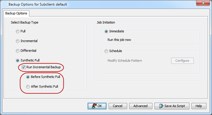

Running an Incremental Backup before or after a Synthetic Full Backup
An incremental backup can be run either before or after a synthetic full backup.
  • Running an incremental backup before the synthetic full ensures that any new or recently changed data is included in the synthetic full.
  • Running an incremental backup after the synthetic full ensures that any new or recently changed data since the backup that occurred prior to the synthetic full, but was not included in the synthetic full, is backed up by the incremental.
The sections below describe the steps to run an incremental backup before or after a synthetic full backup:
  3. From the Backup Options window, select Synthetic Full for Backup Type.
  4. Select Run Incremental Backup and then select Before Synthetic Full or After Synthetic Full options.
  5. Select Immediate for Job Initiation.
    You can track the progress of the backup job from the Job Controller. When the backup has completed, the Job Controller displays Completed.
