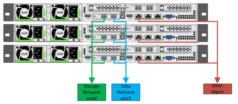

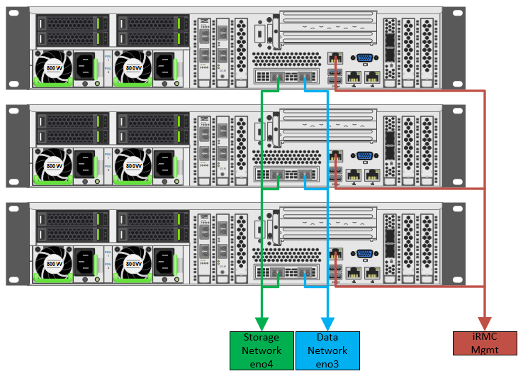

Cabling a Single Connection for Each Network
Connect the 10GbE data network of each node to the data protection network.
Connect the 10GbE storage network of each node to a port on a private non-routable subnet, preferably private vLAN, on the network.
Important
The Storage network and Data Protection network MUST be on two separate subnets, and preferably the Storage network should be on a private vLAN.
Connect the 1GbE iRMC to the management network.
Important
If the CommServe is configured on the appliance, this network must have a route to the data protection network.
Click here to view a HS3300 single connection diagram
Click here to view a HS1300 single connection diagram

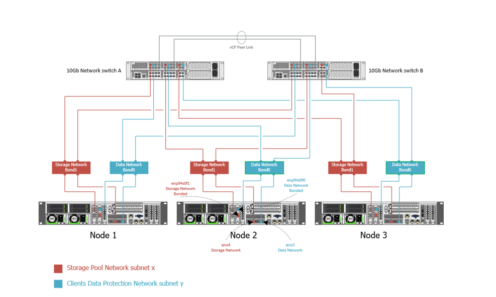

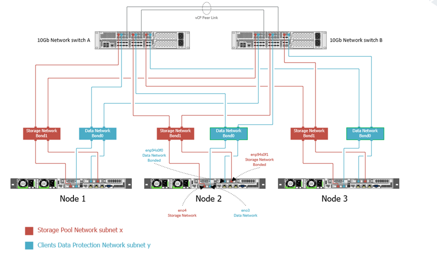

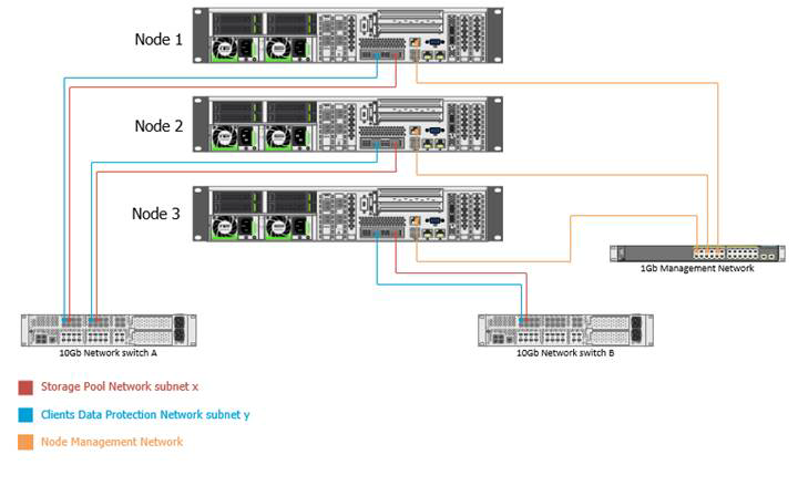

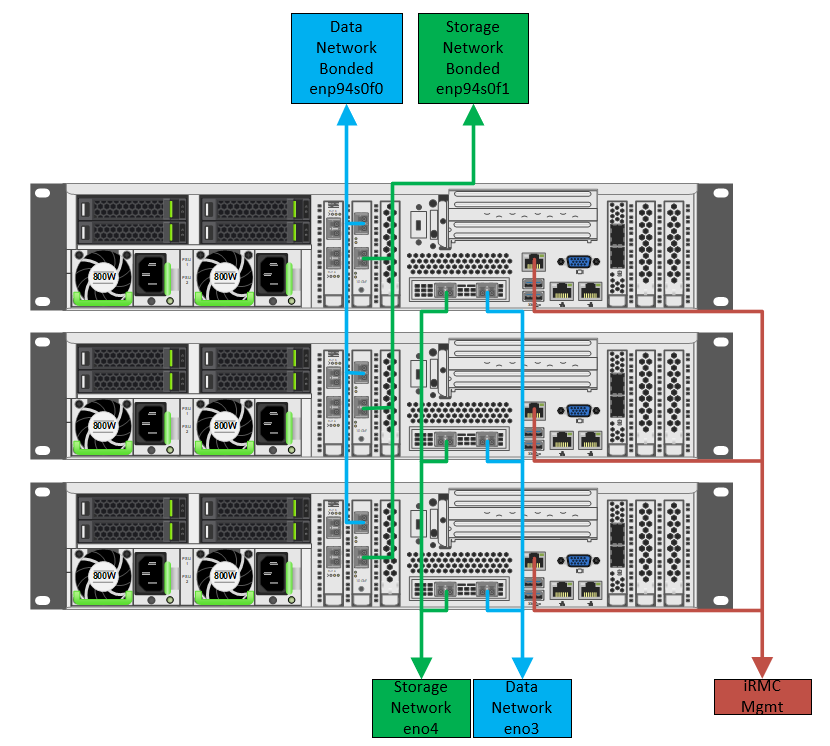

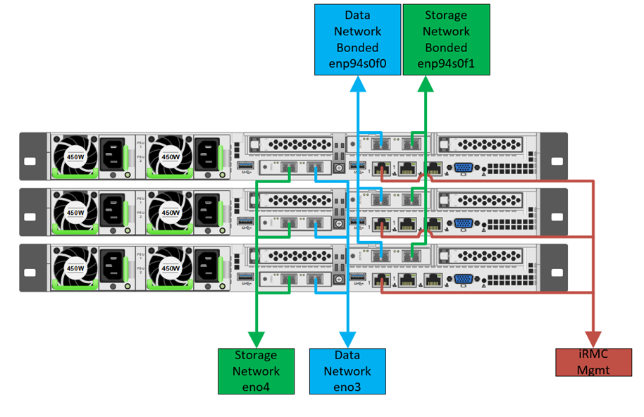

Cabling a Bonded Connection for Each Network

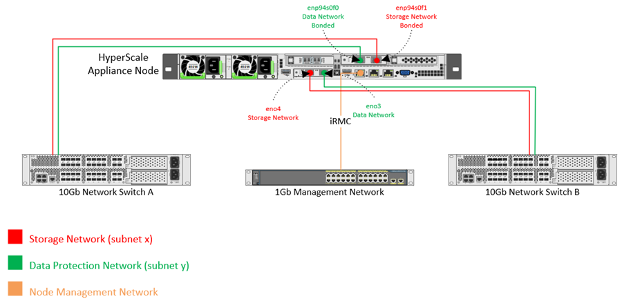

Connect the 10GbE data protection network of each node to the data protection network on switch A and switch B.
Connect the 10GbE storage network of each node to the private storage network on switch A and switch B.
Important
The Storage network and Data Protection network MUST be on two separate subnets, Best practice is to isolate the Storage network on a private vLAN.
Connect the 1GbE to iRMC, network.
Important
If the Commserve is configured on the appliance, this network must have a route to the data protection network.
Click here to view a HS3300 bonded connection diagram
Click here to view a HS1300 bonded connection diagram

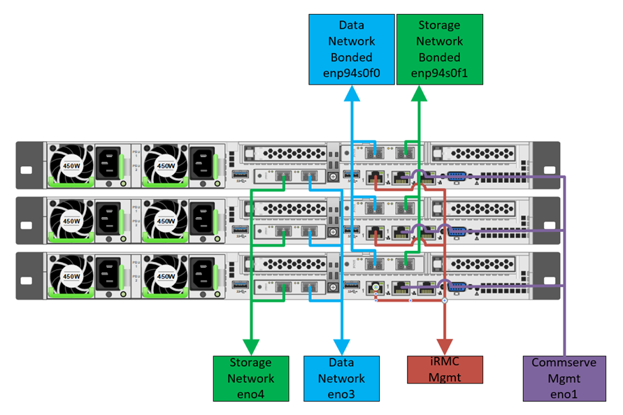

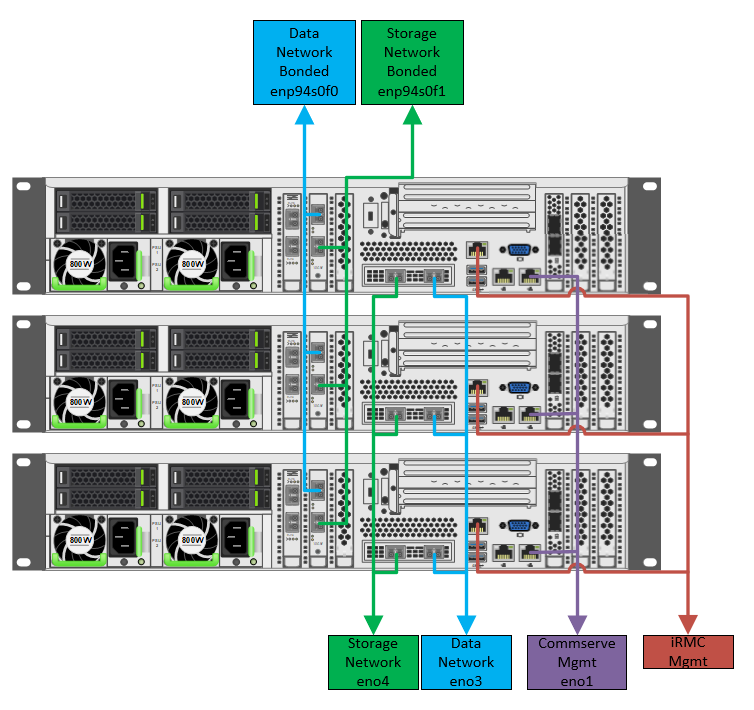

Optionally, connect another 1GbE to the CommServe management network.
Click here to view a HS3300 bonded connection with management network
Click here to view a HS1300 bonded connection with management network

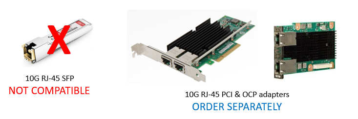

Optional 10GBASE-T RJ45 Copper Interfaces
The 10GBASE-T RJ45 SFP is not compatible with the 10Gb network adapters that come with the HyperScale appliances. (See figure below.) The optional 10GBASE-T RJ45 network adapters must be ordered separately.
Customers may request optional copper 10GBASE-T network adapters to replace the default SFP+ optical/twinax interfaces. The adapters must be ordered separately from Commvault.
In the HS1300 and HS3300 appliances, the SFP+ optical Network adapters must be removed and the 10GBASE-T RJ45 network adapters installed in the same slots in order to maintain the port naming.
In the RO1100 appliance, SFP+ or RJ45 network adapters can be ordered.
