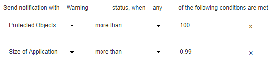

  7. To add more alerts based on information in columns, click Add Condition, specify the column name and value, and then choose when to send notifications.
    • To send the notification when all column conditions are met, next to Send notification email when, select all.
      You can use all when you specify a range with less than and more than on the same numeric type column. Otherwise, you cannot use all when you set multiple conditions on the same column.
      For example:
      Select all, select Protected Objects, select less than, and then type 200.
      alert all conditions met example
    • To send the notification when any of the column conditions are met, next to Send notification email when, select any.
      For example:
      Select any, select Size of Application, select more than, and then type 0.99.
      alert any conditions met example

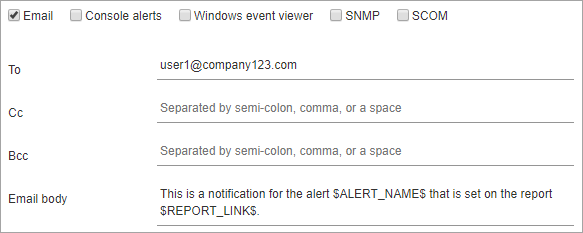

  9. Specify the methods for sending alerts:
    • To send the alert in an email, select Email, and in the To, Cc, and Bcc box, type email addresses, and then enter any additional email text in the Email body box.
      alert notification settings example
    • To send the alert through the CommCell Console alerts system, select Console alerts.
    • To send the alert using the Windows Event Viewer, select Windows event viewer, and then in the Description box, configure the alert message.
    • To send the alert using SNMP traps, select SNMP, and then in the Description box, configure the alert message.
    • To send the alert using SCOM, select SCOM, and then in the Description box, configure the alert message.
    For instructions, see Configuring Windows Event Viewer and SNMP Trap Alert Messages.
    For more information on the alert types, see Alert Types.
