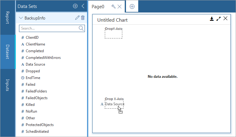

From the Visualization tab, drag Vertical Bar or Horizontal Bar to the Drop components to build the report box.
From the Data Sets list, drag an alphabetic-type field name to the Drop X-Axis box.
By default, the Y-Axis will display a count of the field that you selected for the X-Axis.

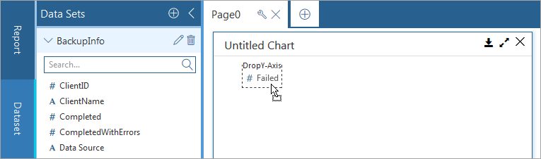

If you want to graph something other than the default, delete the Y-Axis selection, and from the Data Sets list, drag another field name to the Drop Y-Axis box.
A list appears under Drop Y-Axis.
Select an option for the type of aggregate information that you want to display in the chart.
Options vary based on the type of field that you select.
You can drop multiple field names into the Drop Y-Axis box to plot multiple bars in the chart.
