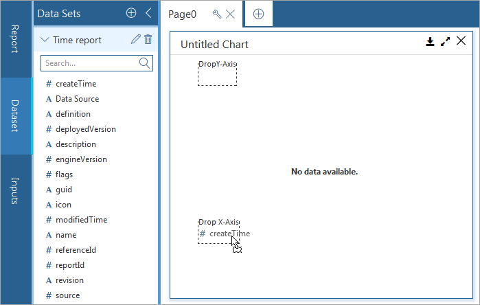

Drag Line Chart or Timeline Chart to the Drop components to build the report box.
From the Data Sets list, drag a field name to the Drop X-Axis box.
Timeline charts support only time stamp, date, and integer field types for the first field in the Drop X-Axis box. While integer field types are allowed, they are assumed to be UNIX timestamps in Coordinated Universal Time (UTC).
