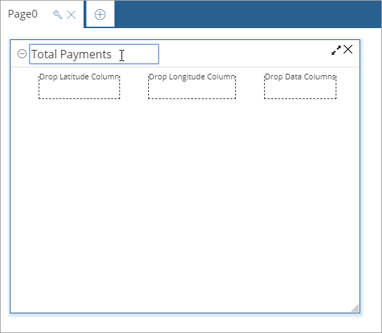

From Visualization, drag Map to the Drop components to build the report box.
In the box at the top of the map component, enter a title for the map.

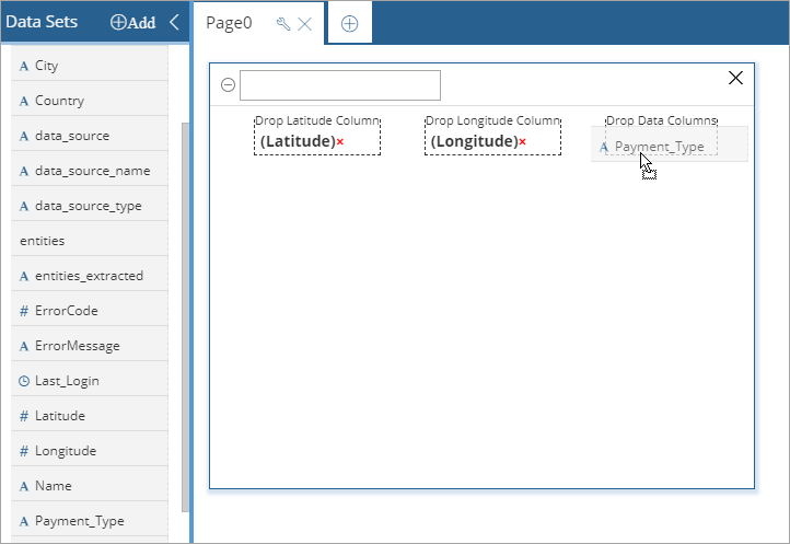

To display the map based on latitude and longitude, configure the columns:
From the Data Sets list, drag a latitudinal field to the Drop Latitude Column box.
From the Data Sets list, drag a longitudinal field to the Drop Longitude Column box.

Optional: To display additional data, drag a field to the Drop Category Column box.
From the Data Sets list, drag a field to the Drop Data Columns box.
To plot additional information in the chart, you can drop multiple fields into the Drop Data Columns box.
