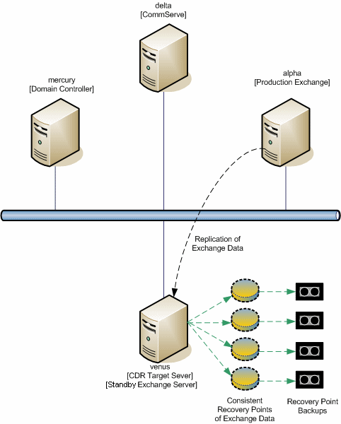

Configuration
dr_exchange_01 The configuration described in this document involves setting up CDR to replicate to the Standby Exchange server directly. The Standby Exchange machine will replace the production machine by assuming its name but keep its existing IP address. The original DNS entry for the Standby Exchange Server will remain but the IP address for the Production Exchange Server will be set to the IP address of the Standby Server.
The following sections discuss preparing the Production and Standby Servers as well as setting up replication.

Setting up Replication
Now that the servers are prepared and the CommCell software has been installed, the replication set and associated replication pairs can be set up and replication initiated. The replication set and pairs can be either configured manually, or by the use of wizard. Though not required, when live replica data is used to bring up the Standby Exchange server - it avoids a Copyback operation. Note the destination paths on the target must be set to mimic the source. See ContinuousDataReplicator for more details on installation and configuration of CDR.
When the pairs are in sync and all of the initial data has been replicated to the target (venus), the next step is to schedule Consistent Recovery Points along with backups of those Recovery Points. This allows for Point-In-Time recovery for the Exchange Server with known consistent data. Alternatively, the live data can be utilized to provide the closest to up to the minute recovery. However, note that live data will be crash consistent at best and is not guaranteed to be recoverable by Exchange.
