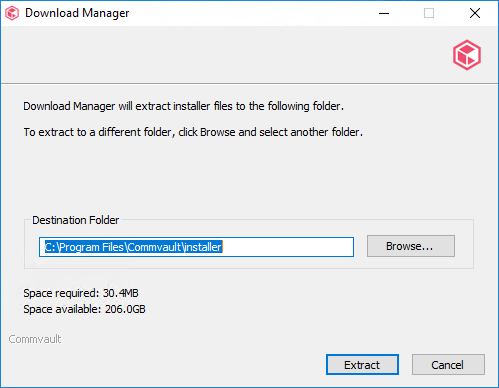

  2. Launch the Commvault software installation package.
    The Download Manager dialog box appears.
    embd_Installing the Standby CommServe Host procedure (9)
  3. Click Extract.

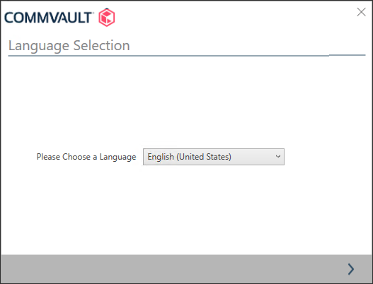

    The Language Selection page appears.
    embd_Installing the Standby CommServe Host procedure (10)
  4. Select the language from the Please Choose a Language list, and then click the arrow to proceed.

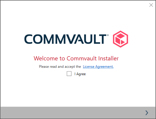

    The Welcome page appears.
    embd_Installing the Standby CommServe Host procedure (11)
  5. Select the I Agree check box, and then click the arrow to proceed.

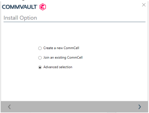

  6. Click Install packages on this computer, and then click the arrow to proceed.
    The Install Option page appears.
    embd_Installing the Standby CommServe Host procedure (30)
  7. Select Advanced selection, and then click the arrow to proceed.

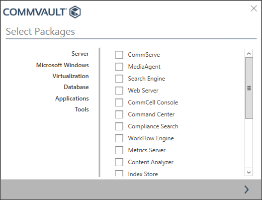

    The Select Packages page is displayed.
    embd_Installing the Production CommServe Host procedure (29)
  8. Select the following check boxes, and then click the arrow to proceed.
    • CommServe check box
    • CommServe Failover check box (Scroll through the list to locate this package.)
      The CommServe Failover package automatically installs the SQL Server agent and the CommServe Failover packages in a new instance. (No additional user intervention is needed.)

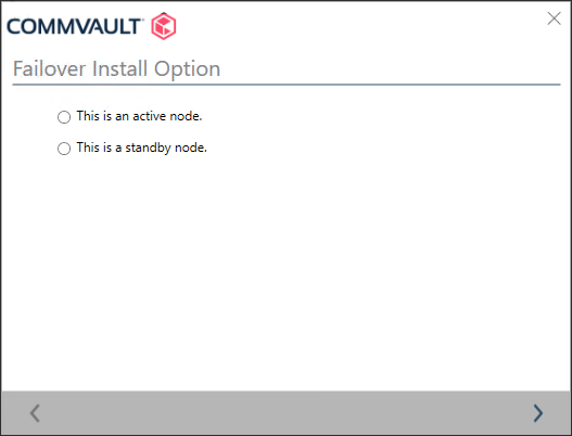

  10. The Failover Install Option page appears.
    embd_Installing the Standby CommServe Host procedure (14)
  11. Select This is a standby node, and then click the arrow to proceed.
    The Installation Path page appears.

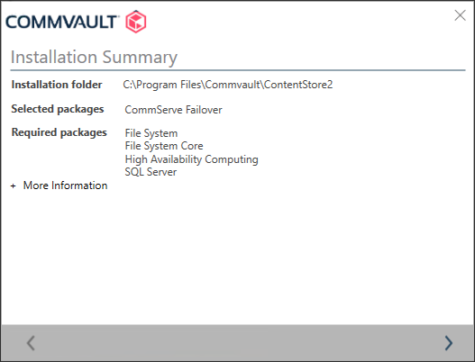

    The Installation Summary page appears.
    embd_Installing the Standby CommServe Host procedure (16)
  13. Verify the list of packages, and then click the arrow to proceed.

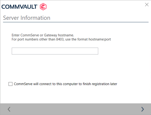

  15. Select / enter the following information:
    • Type the Fully Qualified Domain Name (FQDN) of the production CommServe host.
    • Select the CommServe will connect to this computer to finish registration later option if the CommServe computer must initiate communications with the client.
    Click the arrow to proceed.

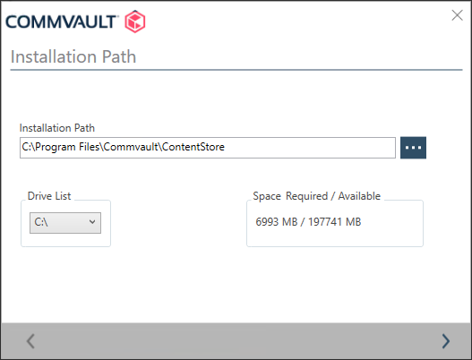

    embd_Installing the Standby CommServe Host procedure (22)
  18. Verify the path (or specify a new the path) for the standby CommServe server, and then click the arrow to proceed.

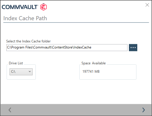

    The Index Cache Path page is displayed.
    embd_Installing the Standby CommServe Host procedure (23)
  19. Verify the index cache path (or specify a new path), and then click the arrow to proceed.

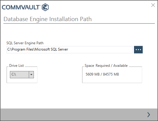

    The Database Engine Installation Path page is displayed.
    embd_Installing the Production CommServe Host procedure (34)
  20. Verify the database engine installation path (or specify a new path) and then click the arrow to proceed. (This is the path for installing Microsoft SQL Server.)

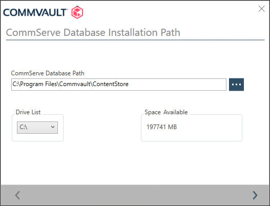

    The CommServe Database Installation Path page appears.
    embd_Installing the Standby CommServe Host procedure (24)
  21. Verify the CommServe database installation path (or specify a new path) and then click the arrow to proceed. (This is the path for storing the CommServe server databases.)

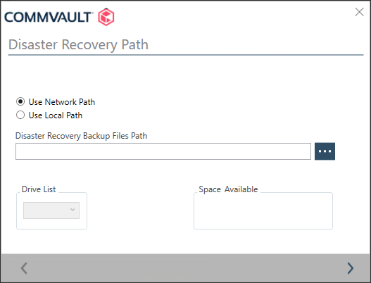

    The Disaster Recovery Path page appears.
    embd_Installing the Standby CommServe Host procedure (25)
  22. Select Use Network Path or Use Local Path, enter the path in Disaster Recovery Backup Files Path, and then click the arrow to proceed.
