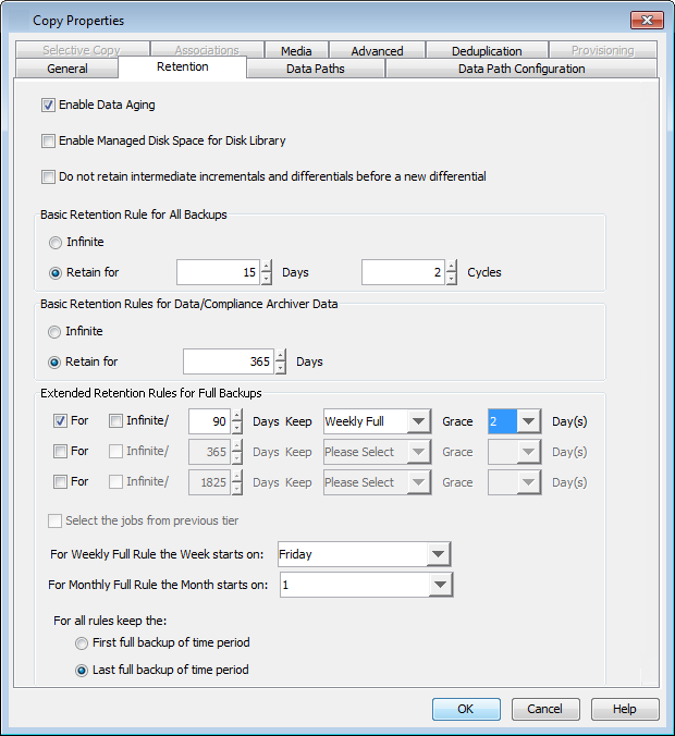

Setting Up the Basic Retention Rule
  1. From the CommCell Browser, expand Policies > Storage Policies > storage_policy.
  2. Right-click the appropriate storage policy copy, and then click the Properties.
  3. In the Copy Properties dialog box, on the Retention tab, under Basic Retention Rule for All Backups, click the Retain For.
    • Enter number of days to retain the data.
    • Enter number of cycles to retain the data.
  4. Click OK.
  5. In the Confirm Basic Retention dialog box, click Yes.
  6. On the ribbon in the CommCell Console, on the Reports tab, click Forecast, and then click Run.
  7. The Data Retention Forecast and Compliance report displays the data to be pruned when a data aging job is run.

Setting Up the Extended Retention Rules
Use the following steps for setting up the extended retention rules:
  1. Right-click the storage policy copy and click Properties.
  2. Click the Retention tab.
  3. Set the basic retention rules by clicking Retain for and entering the number of days and cycles appropriate for your organization.
  4. Set the extended retention rules as follows:
    1. Click the For button.
    2. Enter the number of Days Total to retain the backup.
    3. Click the Keep drop-down list, and select the desired backup criteria (for example, Monthly Full, Weekly Full).
    4. Click the Grace Days drop-down list and select the number of days (for example, 2).
      This allows you to consider the additional number of days along with the Extended Retention rule. For example, if the last full backup job fails with in the defined extended retention criteria, then the next full backup job that ran in the specified grace days will be selected for retention.
  5. Repeat Step 4 to configure additional extended retention.
