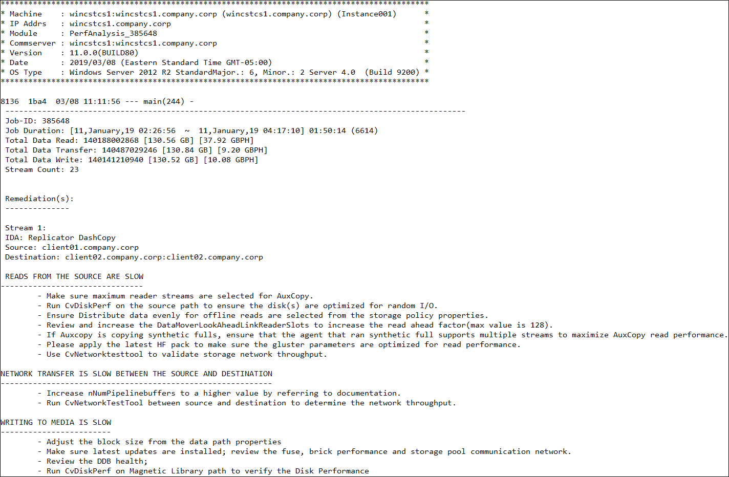

Sample Output
The following is a sample log file report for Job ID 385648:
