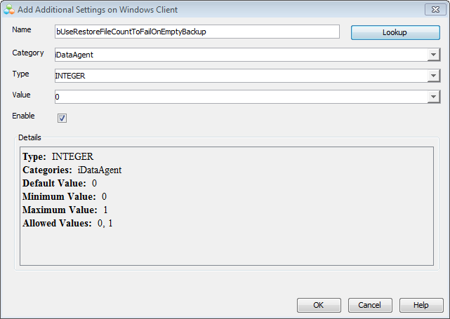

Restore operation goes to a pending state
Symptom
You may see something similar to the following message in the StartIFRestore.log in the CommServe:
ServerNotifyCallBack::updateJobMgrProgress() - File Statistics: Succeeded [0], Skipped [0], Failed [0]
Cause
When there is no change in the data during the time interval between an incremental prior to and after a synthetic full backup, the subsequent incremental backup will complete successfully even though no data got backed up. But the restore operation may go to a pending state.
Resolution
To complete the restore operation successfully, set the bUseRestoreFileCountToFailOnEmptyBackup additional settings to zero. Use the following steps to enable the additional settings:
  1. From the CommCell Browser, navigate to the CommServe.
  2. Right-click the <CommServe>, and then click Properties.
  3. On the CommServe Properties dialog box, click Advanced.
  4. Click the Additional Settings tab.
  5. Click Add.
  6. In the Name box, type bUseRestoreFileCountToFailOnEmptyBackup. The Category and Type details will be automatically populated.
  7. In the Value box, type 0.
  8. Click OK to save the additional setting configuration.
  9. Click OK.
