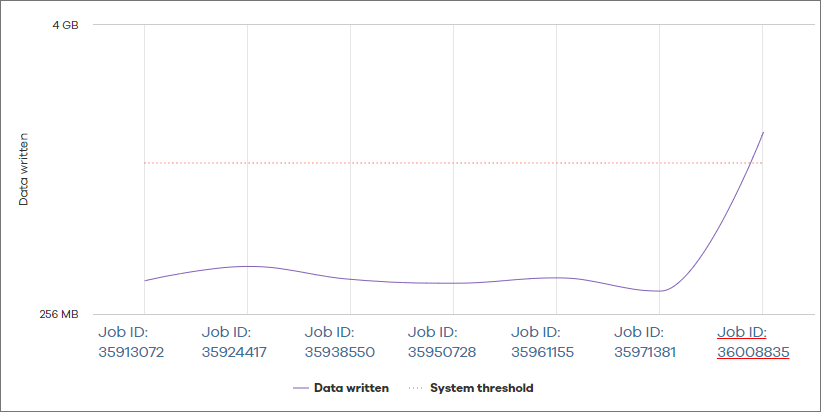

Backup Size Chart
The Backup Size chart displays the amount of data written for the last 7 backup jobs, along with a system-defined threshold (dashed line).
The following image is an example of the Backup Size chart for VM backup size anomalies:
Threat Indicators report for size-related anomalies - VM

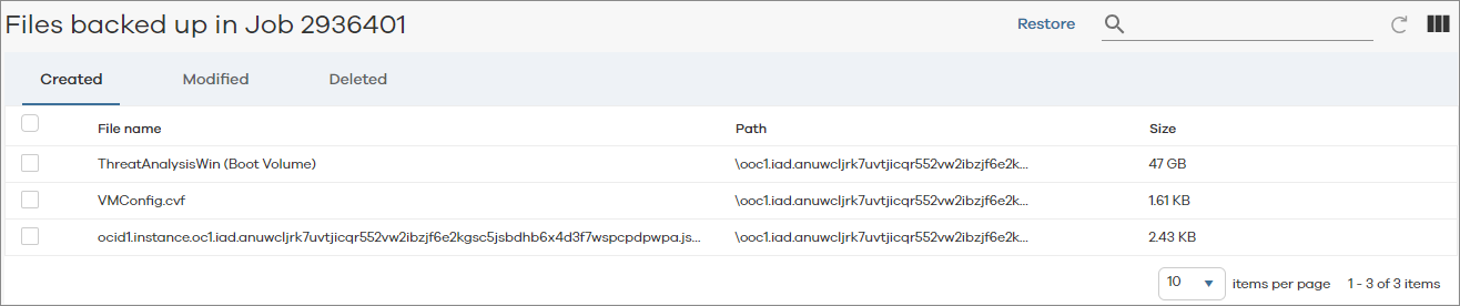

Files Backed Up Table
Click a Job ID in the lower part of the Backup Size chart to populate the Files Backed Up table.
The Files Backed Up table is comprised of detailed information about the size of affected backup job files in the virtual machine, categorized into three tabs: Created, Modified, and Deleted.
The following image is an example of the Files Backed Up table for VM backup size anomalies:
embd_report description Unusual File Activity Report for File-Related Anomalies (1)
To restore a path that has unusual file activity, select the checkbox of the path in the Files Backed Up table, and then click Restore.
The following table includes descriptions for all columns in the Files Backed Up table for VM backup size anomalies.
