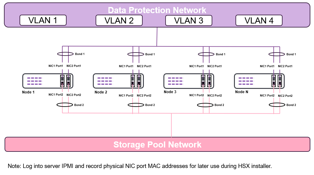

This topology allows multiple tagged VLANs to connect to the appliance using the bonded data protection interface. This allows connection to multiple non-routable networks used to avoid sending backup traffic through a router or firewall.
  • 2 - 10 GbE bonded ports for data protection which will connect to multiple tagged VLANs to transfer data to and from the clients being protected and connect to the Server Gateway. This will include connections to:
    • 2 or more VLAN IDs
    • 2 or more IP addresses based on the number of VLANs
    One of the VLANs must remain routable to connect to the Server Gateway.
  • 2- 10 GbE bonded ports for storage pool which is a dedicated private network, used for communication and replication between the HyperScale nodes.
VLAN topology connects multiple VLANs directly to the HyperScale X Appliance nodes over a single physical connection. This is typically used to connect directly to different networks to avoid traversing routers or firewalls that can become a bottleneck, or to connect to isolated networks. This can be combined with the bonded configurations to provide redundancy using either the Active-Backup bonding or the Link Aggregation Control Protocol (LACP). This can also be used with a multi-switch link aggregation protocol such as Virtual Port Channel (VPC), MLAG, or MC-LAG to provide switch level redundancy.

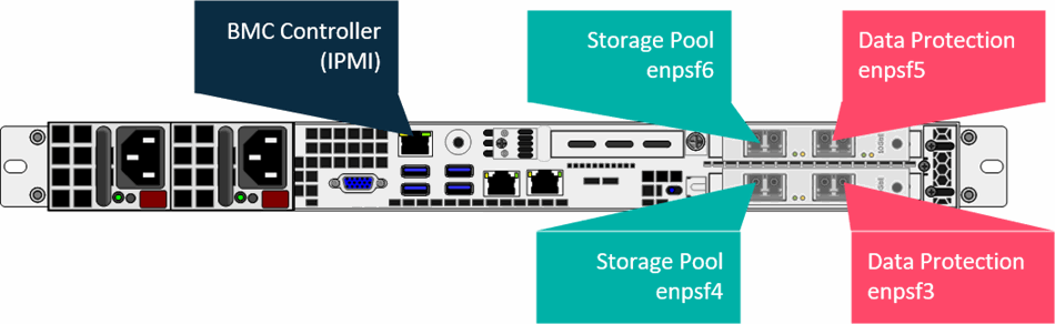

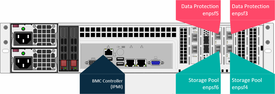

  1. Connect the 2 - 10 GbE data protection port from each node to the data protection network.
    All data management tasks including backups and restores, are established through the 2 - 10GbE data protection ports.
  2. Connect 2- 10 GbE storage pool port from each node to the private storage pool network.
    All storage related tasks, including all cluster connectivity for the storage pool network, will be through these 2- 10 GbE storage pool ports.
  3. Connect the 1 GbE IPMI port (BMC Controller) from each node to the IPMI or management or utility network for lights out access.
