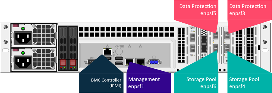

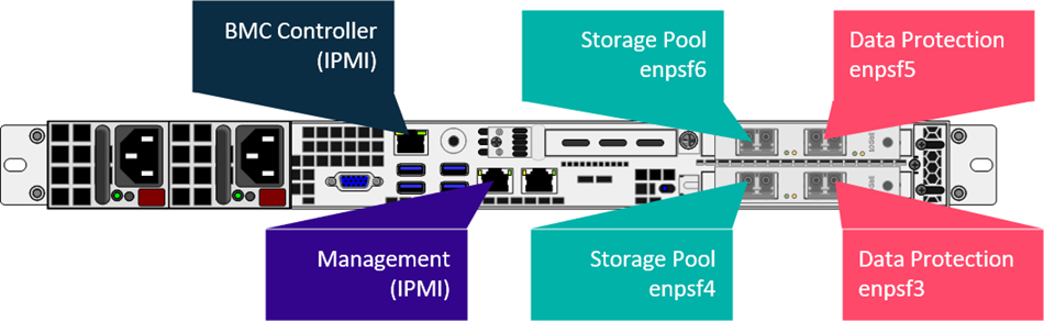

Cabling and Cable Connections
Connect 2 - 10 GbE data protection ports from each node to the data protection network.
All data management tasks including backups and restores, are established through the 2 - 10 GbE data protection ports.
Connect 2- 10 GbE storage pool port from each node to the private storage pool network.
All storage related tasks, including all cluster connectivity for the storage pool network, will be through these 2- 10 GbE storage pool ports.
Connect the 1 GbE IPMI port (BMC Controller) from each node to the IPMI or management or utility network for lights out access.
Connect the 1GbE management port to the management network.
All management related activities, such as connecting to the CommServe, accessing the DNS server, etc. will be established through the management port.

Required Network Cables
2x 1 GbE network cables for the iRMC and management ports
4x 10 GbE network cables for the bonded data protection and storage pool ports
6x 1 GbE network cables for the iRMC and management ports
12x 10 GbE network cables for the bonded data protection and storage pool ports
