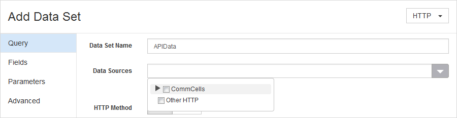

  6. In the Data Sources list, select the name of a data source:
    • To use Commvault REST APIs, select CommCells.
    • To use third-party REST APIs, select Other HTTP.

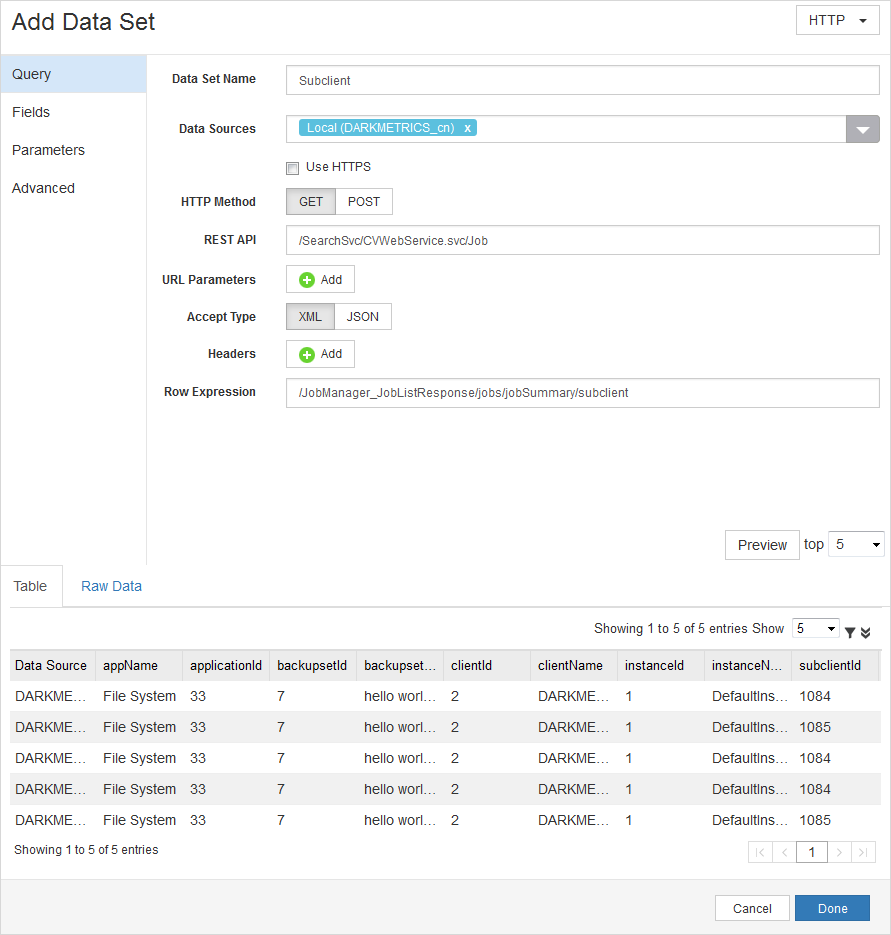

  8. Next to HTTP Method, select the type of REST API you want to use to collect or send data:
    • If you select GET, you must complete the following steps:

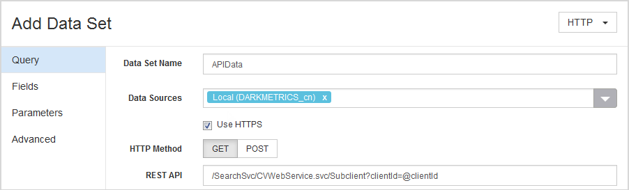

      • In the REST API box, enter the path for the REST API that you want to use.
        For example: /SearchSvc/CVWebService.svc/Job
        Commvault REST API data sets can be used only on CommServe computers. For a list of REST APIs, see REST API - API Library.
        Authorization tokens will be automatically entered in the headers for the local CommCell environment's Web Server.

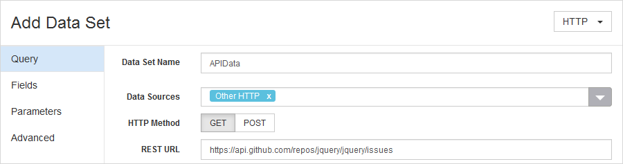

      • For third-party REST APIs, in the REST URL box, enter the address for the REST API that you want to use.
        For example: https://api.github.com/repos/jquery/jquery/issues
        other_http_data_set

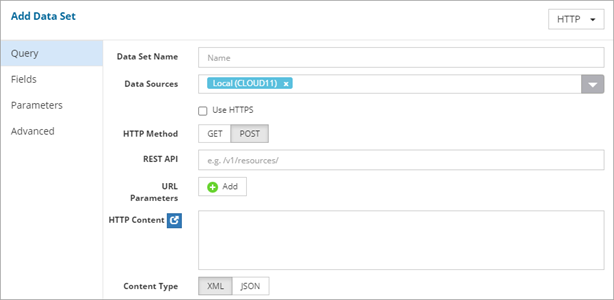

    • If you select POST, you must complete the following steps:
      • To add URL parameters, click Add.
      • In the Key box, type a name, and then in the Value box, type the value that you created on the Parameter tab.
      • In the HTTP Content box, enter the request content that you want to send to the server.
      • Next to Content type, to specify the language of the content, select XML or JSON.
        http_dataset_post_method
  9. Next to Accept Type, to specify the language you want to receive information in, select XML or JSON.
    If you select XML, on the Fields tab, an XPath expression is displayed for each field, and if you select JSON, a JSONPath expression is displayed for each field.
  10. If you are using third-party REST APIs and you want to use headers, next to Headers, click Add, and then specify the Header and Value in the boxes.
  11. Click Preview to retrieve all possible row expressions from the response to the REST API or REST URL that you entered.
    If you leave the Row Expression box blank, all available rows appear in the Row Expression box in either XPath or JSONPath.

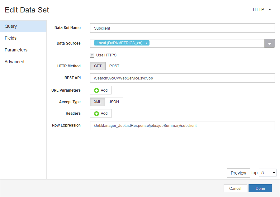

  12. Configure the row expression for Commvault REST APIs or third-party REST APIs:
    • For Commvault REST APIs, in the Row Expression box, edit the XPath or JSONPath row expression to retrieve the data that you want to use in your data set.
      XPath example: /JobManager_JobListResponse/jobs/jobSummary/subclient
      xpath_row_exp

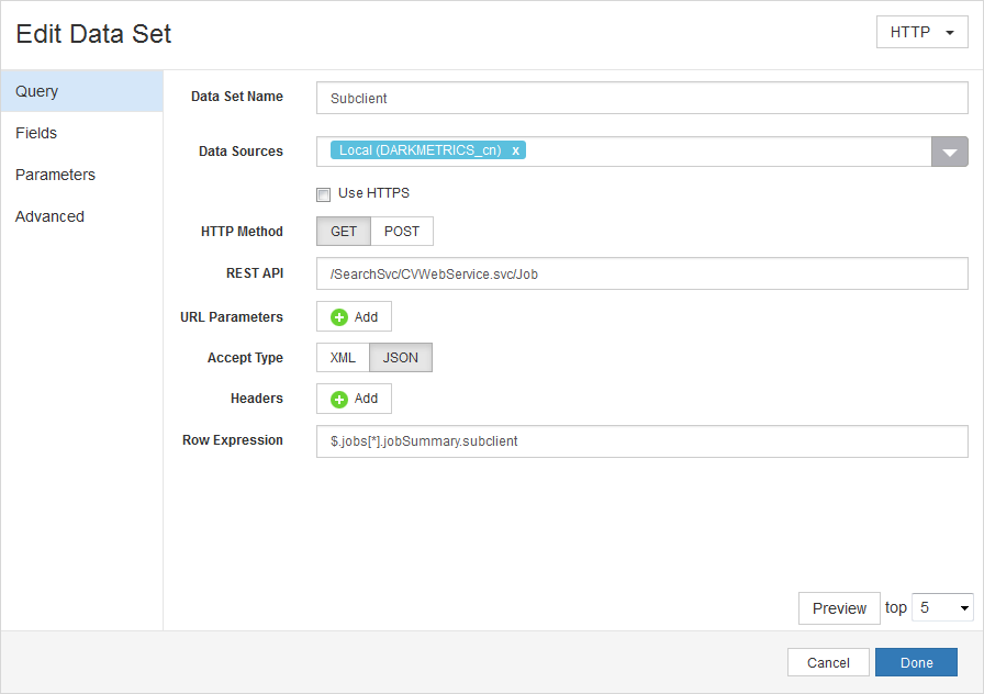

      JSONPath example: $.jobs[*].jobSummary.subclient
      jsonpath_row_exp

  13. Click Preview to retrieve the fields from the response.
    This image is an example of Commvault REST API using XPath:
    http_dataset_rest_api

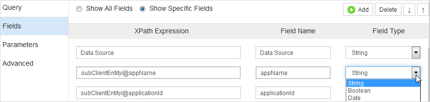

  15. Optional: Change the field type for each XPath expression. Under Field Type, click any box to select a different value.
    rest_api_field_type
