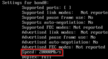

From the output, verify that the listed speed for the bonded interface is double the speed of the child interface.
For example, when bonding 2 x 10 Gigabit interfaces the speed should be 20000Mb/s (as shown in the following sample image:
