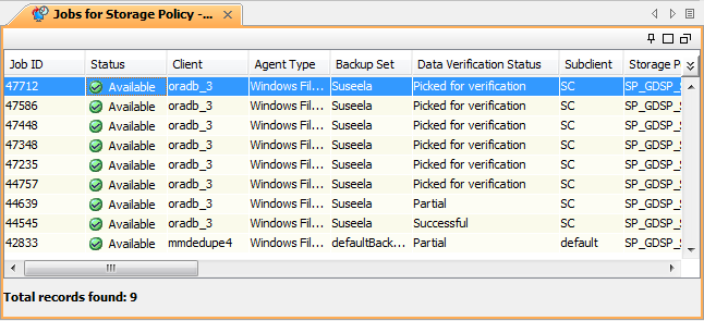

View Status of Data Verification Job
Once a data verification operation is run, you can view the data verification status of the jobs. The following table describes the data verification status that is displayed in the Data Verification Status column:
| Status | When Displayed |
| Not Picked | A job has not been picked for a data verification operation. |
| Picked for Verification | A job has been picked for a data verification operation. |
| Successful | A data verification operation ran and successfully verified this job. |
| Failed | A data verification operation ran and failed to verify this job. |
| Partial | A data verification operation ran and has not yet completed verifying this job. |
From the CommCell Browser, expand Policies | Storage Policies | <Storage Policy>
Right-click the appropriate storage policy copy for which you verified the data, point to View and then click Jobs. Once a data verification operation is run, the status of the data verification, the date and time of the operation is displayed in the Data Verification Status and Last Verified On column.  If this copy has already been configured for data verification, then individual backups do not have to be selected on the copy.
Pick a Job for Data Verification
You can select individual or multiple jobs to be verified during a data verification operation from the Jobs for Storage Policy Copy window. You can verify jobs on all types of storage policies. The example below is for an iDataAgent Backup storage policy.
Right click the <Storage Policy Copy> from the right pane for which you want to verify the jobs, point to View and then click Jobs.
From the Job Filter for Storage Policy dialog box, select the necessary options.
From the Jobs for Storage Policy Copy windows, right-click a job, then click Pick for Data Verification. To select multiple jobs, hold down the Ctrl key and click on each job that you want to select.
If you then decide that you do not want this job to be verified during a data verification operation, right-click the job and click Do Not Verify Data.
Once a job is picked, its status in the Data Verification Status column is displayed as Picked for Verification.
