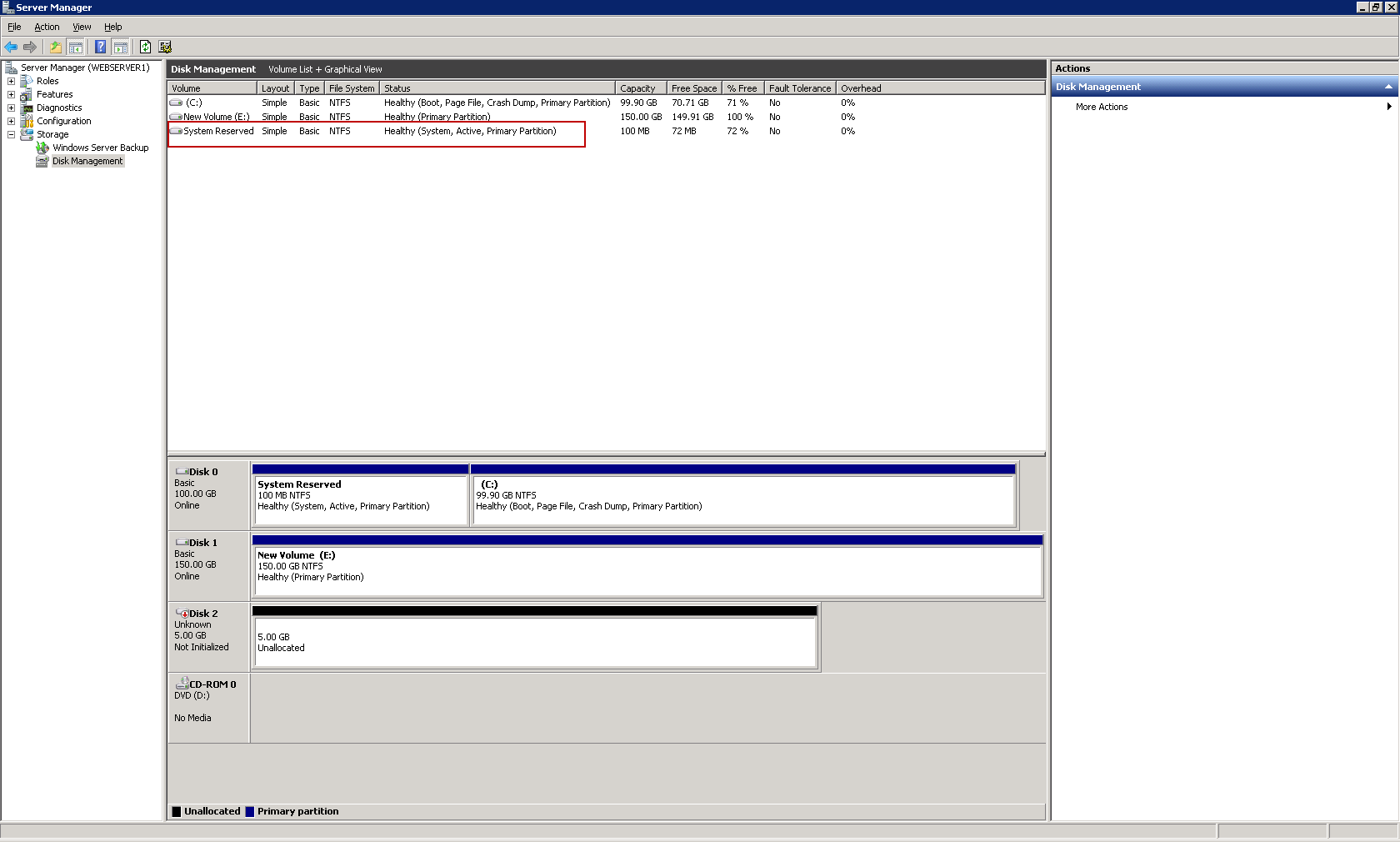

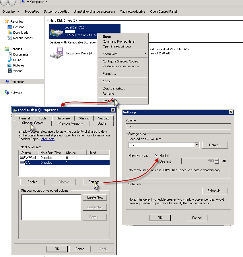

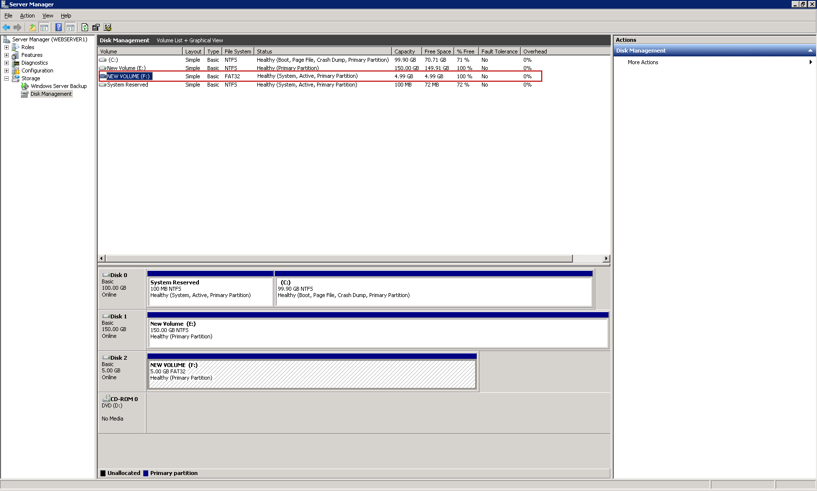

Make sure that the drive that hosts the snapshots has sufficient space to post the new snapshot.
To resolve this issue,
Verify if there is an Active, Primary Partition that is not an NTFS file system and does not have a Volume drive letter assigned.  The following image is an example of an Active, Primary Partition that is not NTFS (New Technology File System).  Run mountvol command from the Command Prompt at the administrator level. This will list the volumes available and their names. You can also view this list under the registry key located at HKLM\System\MountedDevices. Look for a data set without a matching\DosDevice\Volume drive letter. The following is an example of a data set without a matching DosDevice\Volume drive letter: \\?\Volume{0c022041-ff03-11de-8b2f-806e6f6e6963Review this with your Server Vendor or Server Image Provider to determine what volume is this for. If this does not resolve the issue, refer to Microsoft KB 968128 for more information.

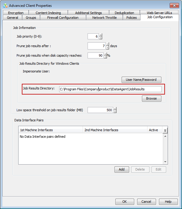

This issue is caused by a problem writing to the Job Results directory on the client computer.
From the CommCell Console, navigate to Client Computers | <Client>.
Click Advanced.
Click Job Configuration tab. The Job Results Directory box contains the path where the job results files are listed. Make sure that the given path exists.
Login to the Client Computer and verify if the current free space available is sufficient for hosting the Job Results Directory. For more information on how to determine the free space for Windows 2008 and Windows 2008 R2, see Microsoft KB article 2021748.

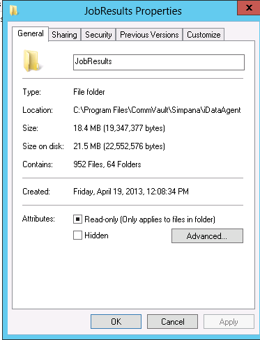

Navigate to the path provided in the Job Results Directory box and check the size of the JobResults folder.
Explore the options required to reduce the space or move JobResults folder to another location.

System state backup of an active partition that is not NTFS formatted can result in backup failure.
Resolution 1
See Backup Failures on Windows 2008, Windows 2008 R2 or Windows 7 for more information.

Symptom 4
The following errors appear due to space issues with the Volume Shadow Service.
Server operating system Event Log File TYPE] Error [TIME] 2011/09/23 09:03:04 [SOURCE] volsnap [COMPUTER] server name [DESCRIPTION] When preparing a new volume shadow copy for volume ?:, the shadow copy storage on volume ??: could not be located in non-critical space. Consider using a shadow copy storage volume that does not have any shadow copies.
FileScan.log 23924: [PID] [Thread] 09/23 09:03:05[JobID] CsVssAsync::WaitUntilDone() - Async status returned code = 0x8004231f, Description = Unknown status. 23924: [PID] [Thread]09/23 09:03:05 [JobID] CsSnapRequestor::DoShadowSet() - Call asyncShadow.WaitUntilDone() [FAILED, throwing CV exception] - Code = 0x8004231f, Description = VSS_E_INSUFFICIENT_STORAGE 23925: [PID] [Thread]09/23 09:03:05 [JobID] CsSnapRequestor::CreateSnapshotSet() - Call DoShadowSet() [FAILED, throwing CV exception] - Code = 0x8004231f, Description = VSS_E_INSUFFICIENT_STORAGE 23926: [PID] [Thread]09/23 09:03:05 [JobID] CsSnapRequestor::Snap() - Call CreateSnapshotSet() [FAILED, throwing CV exception] - Code = 0x8004231f, Description = VSS_E_INSUFFICIENT_STORAGE
Resolution 4
Follow the steps given below to resolve this issue.
Open My Computer on the client computer.
Right-click on the <volume> and point to Properties.
Click on Shadow Copies tab.
Click Settings.
In the Storage area, select Maximum Size as No Limit or the set the space limit required for the VSS copies. You can also move the holding section to another volume.
For Command Line, see Microsoft article Vssadmin add shadowstorage.

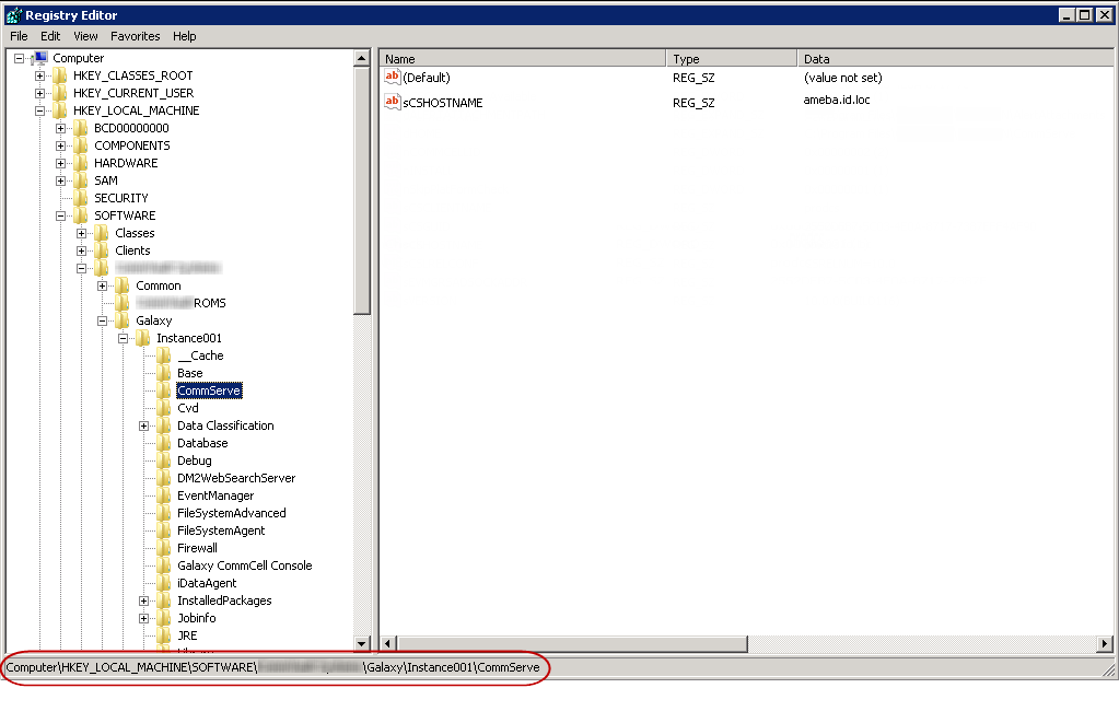

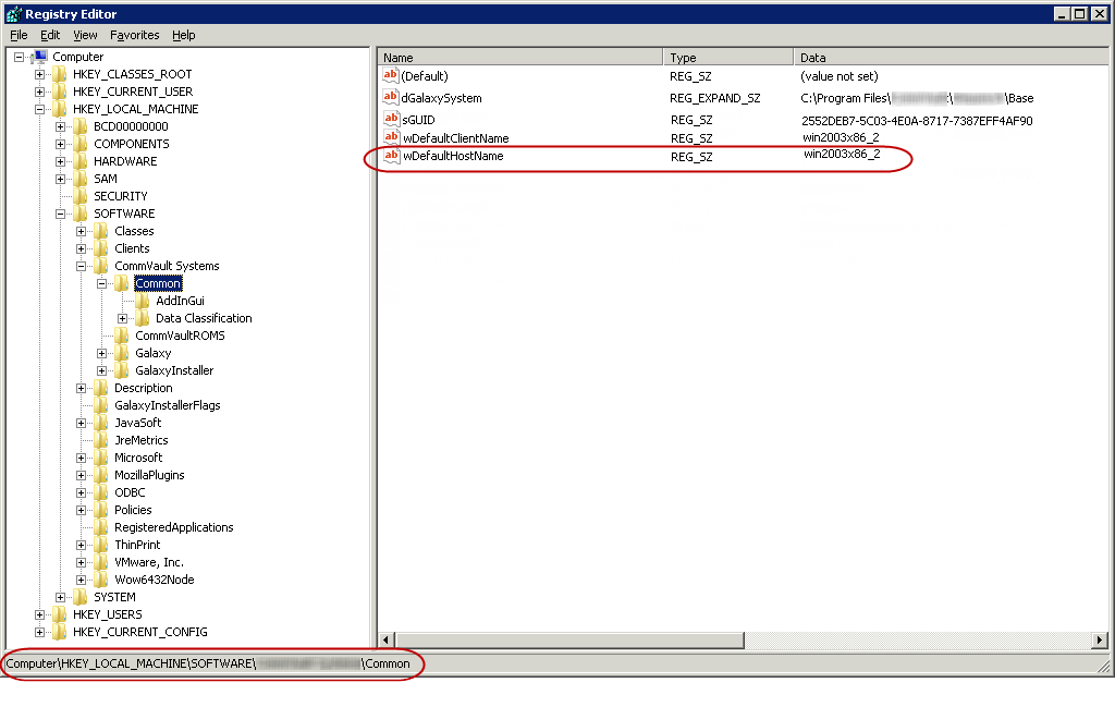

Resolution

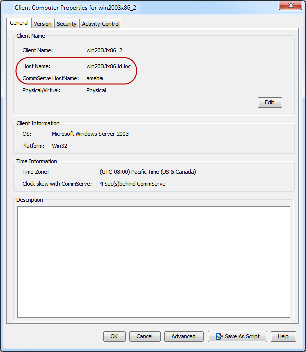

Check the configuration in the CommCell Console for the CommServe, MediaAgent and the Client with issues. Different phases of the backup or restore operations require reviewing different communications paths. Also, check the registry entries on the CommServe, MediaAgent and the Client.
The example below will cover the CommServe and the client computers.
From the CommCell Browser, right click the CommServe and click Properties. Check the CommCell Host Name.
From the CommCell Browser, right click the Client computer and click Properties. Check the Host Name and CommServe Host Name.
The registry on the CommServe (CS) will have two locations that show the CS Host Name when it also has a Client (CL) installed. For the CommServe Name used by the Clients other then the CommServe Client the registry entry for sCSHOSTNAME is located under \HKLM\Software\Commvault Systems\Galaxy\Instance001\CommServe  For the CommServe with a Client (CL) File System Agent installed, the name is hosted at this registry location. Registry entry for wDefaultHostName is located under \HKLM\Software\Commvault Systems\Common
Now to get the information for the MediaAgent (MA) or the Client (CL), locate the MA or CL in the CommCell Browser window, right click, and then click Properties. On the General tab, the following will be displayed. Client used as example here:
Now once the MediaAgent (MA) and/ or Client (CL) CommCell information is confirmed, go to the MA and/or CL and review the registry entries for the Name. Client computer is used for example here. -
To confirm the CL Host Name, check the registry on the CL for the entry wDefaultHostName located under \HKLM\Software\Commvault Systems\Common.
Now confirm the CommServe Hostname on the CL in the registry for the entry sCSHOSTNAME located under \HKLM\Software\Commvault Systems\Galaxy\Instance001\CommServe
For UNIX/ Linux based MA or CL, running the commvault status command will display the CommServe (CS) name as it appears in the /etc/CommvaultRegistry/Galaxy/Instance001/CommServe folder. The .properties file at this location contains the setting. [root@lx5 ~]# commvault status
Now that the CommServe Hostname and the Host Name are confirmed, first confirm DNS supports Lookup and Reverse Lookup for the names. If this is correct and communication works in all directions based on ping, ping -a and nslookup, retry the backup or restore operation. -
If this does not resolve the issue then review the Name Management documentation to get the names matching in the environment.
If this does not resolve the issue then move to first using IP addresses between the CS, MA and CL instead of names.
If this fails to resolve the issue then use host file entries to populate the Resolver cache with the name translations. Enter in this format <IP Address> <Short Name> <FQDName>
Confirm the issue is resolved by running a backup or restore job and checking the Filescan.log, JobManager.log and clRestore.log files.
