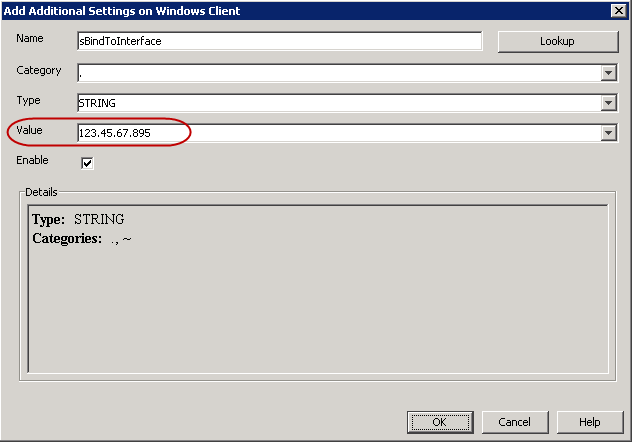

Click the Additional Settings tab and then click Add.
In the Name field of the Add Additional Settings dialog box, type sBindToInterface. The Category and Type details will be automatically populated. Alternatively, you can click Lookup and search for the additional setting using the Find box.
In the Value box, type IP address or host name of the interface to which all services should bind.
Click OK to the additional setting configuration.
