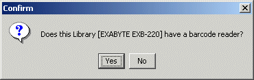

Select the correct button to indicate that the library does not contain a barcode reader. This can be done as follows:
- Click No in the Confirm prompt asking you whether the library has a barcode reader.

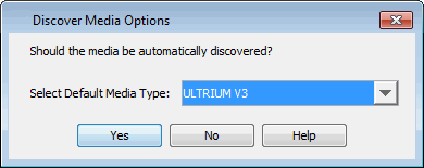

In addition make sure that the correct media type used in the library is selected in the following Discover Media Options dialog box.

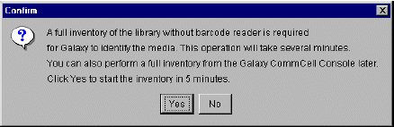

Also ensure that a full inventory is performed on the library. This can be done using either one of the following options:
During the configuration, select Yes in the Confirm prompt asking you whether an inventory operation can be automatically performed after five minutes.
