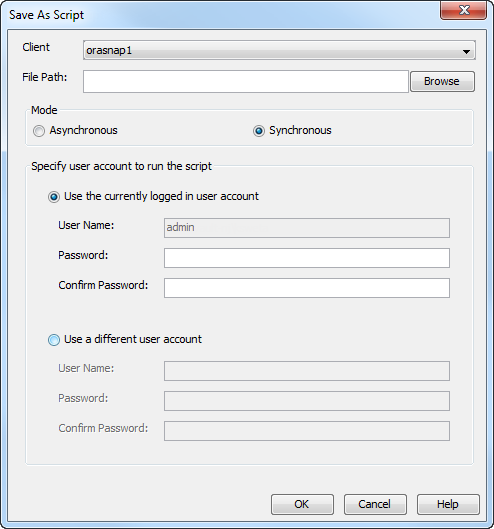

Follow the steps given below to generate a script which you can use to perform a restore from the command line interface:
  1. From the CommCell Browser, navigate to Client Computers | <Client> | Active Directory | <Backup Set>.
  2. Right-click the <Subclient> in the right pane and then click Browse Backup Data.
  3. Click OK.
  4. In the right pane of the Browse window, select the data that you want to restore and click Recover All Selected.
  5. Select the required restore options which you want to execute using the script.
  6. Click Save as Script.
  7. Enter the location to save the script along with the file name and extension. For example, "C:\scripts\myscript.bat" on Windows and "/usr/scripts/myscript.sh" on UNIX. Alternatively, you can also click Browse and navigate to the location.
    The script will be saved as a .xml file and .bat/.sh file.
    If a file with the same name already exists in the specified location, both the .xml and .bat/.sh files will be overwritten.
  8. Enter the username and password for the user account which you want to use to perform the restore.
    By default, the user account which you have used to login to CommCell console is used for performing the restore. However, if the user account does not have access to application and database, click Use a different account.
  9. Click OK.
