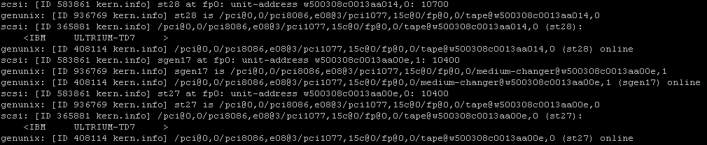

    Example of a library with two drives of like model type:
    Note: IBM ULTIUM-TD7 drives are bound to st27 and st28 in the image.

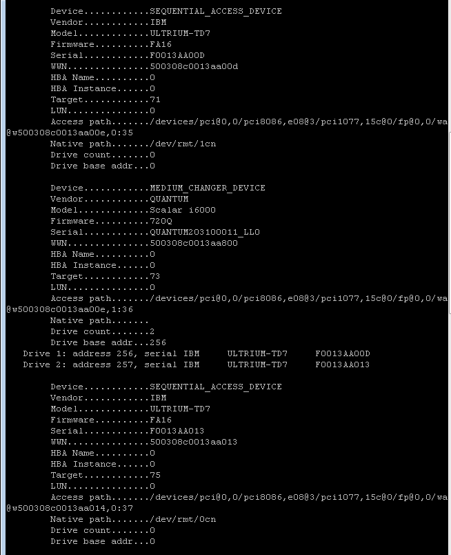

  7. Run the ScanScsiTool found in the <software installation path>/Base folder to obtain the native path for each drive type connected.
    Example of ScanScsitool output for a library and two like model drives:
    lib_example01
  8. Run ScanScsiTool with –T and [native path] of drive.
    For example:
    lib_example02
    Note: The output of the ScanScsiTool with –T and [native path] of each drive type will be required if the library has mixed drive types, or there are several libraries with different drive types attached to the Solaris MediaAgent.

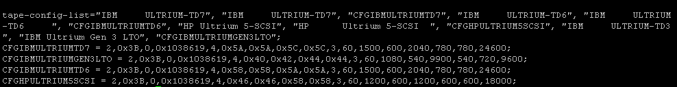

    st.conf file format for a mixed drive type environment:
    tape-config-list="VENDOR Product ID1", "A Prettier Name to Display1", "Config-Name1", "VENDOR Product ID2", "A Prettier Name to Display2", "Config-Name2", "VENDOR Product ID3", "A Prettier Name to Display3", "Config-Name3", "VENDOR Product ID4", "A Prettier Name to Display4", "Config-Name4";
    Config-Name1 = config information1;
    Config-Name2 = config information2;
    Config-Name3 = config information3;
    Config-Name4 = config information4;
    Take notice of the required semicolon (;) at the very end of the tape-config-list as well as after each defined Config-Name with config information entry.
    Example of st.conf file example for mixed drive model type environment:
    lib_example03
