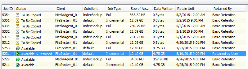

After setting up the retention period on a specific job, the job will retain on the specified date and you can view the following from the Jobs for Storage Policy window.
However, note that if the retention criteria defined on the storage policy copy level is higher than the manual retention end time for a job, the job will follow the storage policy copy level retention and vice versa.
The expiration date appears in the Retain Until column.
In the Status column, the job status changes from Available to Available & Retained, and the job status is preceded with the  retained job icon. retained job icon.
The job follows the higher retention defined on the storage policy copy level or by Retain Until option on the job level. After setting up the retention criteria on a specific job, the job will follow the highest retention criteria.
