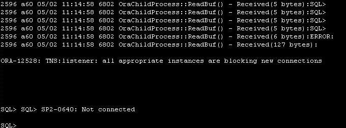

ORCL0001: Error 18:18 Oracle database is not available. The database may be down or in an unknown state
Issue
Offline backups are failing on Windows servers with the following error message:
ORACLE database is not available. The database may be down or in an unknown state
Resolution

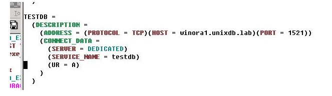

This problem can happen if the TNS configuration for this database does not have a "static" listener. Most Oracle databases use dynamic listeners, and there could be a delay in the listener between the lights-out script starting the database, and the database finishes registering in the dynamic listener, before the CommServe tries to connect back to the database to get its status. If the database does not register quickly enough, the CommServe will fail to connect to the database using the TNS connection resulting in an unknown status and this error.
To resolve this issue, scan the ClOraAgent.log on the client for a connection error to Oracle where TNS is blocking connections.
If this is indeed the error, a directive can be added to the tnsnames.ora file which will prevent the connection from getting blocked when using a dynamic listener.
Go to the %ORACLE_HOME%\NETWORK\admin folder in the oracle server and add (UR = A) to the connect_data directive.
Once this parameter is added, the connection should no longer be blocked, and the backup should run with no errors.
