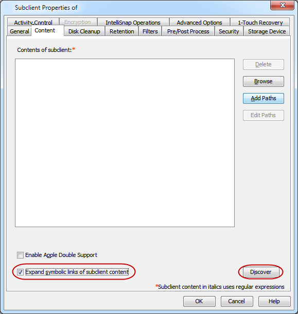

expand_sym_links_snp
  3. Click the Content tab.
  4. Click Browse.
  6. Click Close.
  8. Click OK.
expand_sym_links_sc
/home/user/lib->/usr/lib/
  4. Click Add.
  7. Click OK.

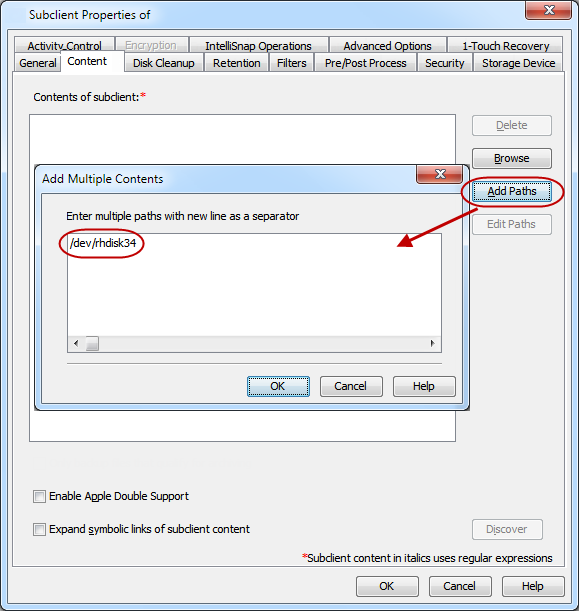

  • Raw devices are backed up using Full Backups.
  • Click the Content tab.
  • Click Add Paths.
  • Click OK.
raw_device_snp

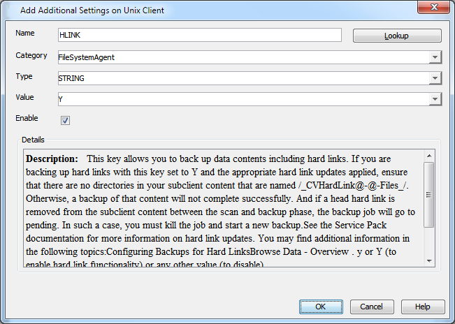

By default, hard links are ignored during backups and the data is duplicated thus taking up additional storage space. You can prevent such data duplication when backing up hard-linked files and also preserve hard links during restores using the following steps.
Additional disk space is required for the job results directory, for more information see Job Results Directory Disk Space Calculation.
  4. Click Add.
  5. In the Name field, type HLINKSNAP.
  6. In the Value field, type Y.
  7. Click OK.

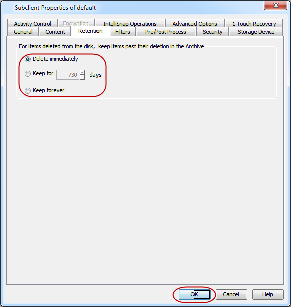

Use these options to retain items deleted from the disk within the archive. You can configure to keep deleted items for specified number of days after deletion or forever. You my also choose to delete these items forever.
  1. From the CommCell Browser, navigate to Client Computers | <Client> | <Agent> | <BackupSet>.
  2. Right-click the Subclient on the right pane, and then click Properties.
  3. Click the Retention tab.
  4. Select from one of the following options:
    • Delete Immediately
      By default, the deleted items are deleted immediately from the archive.
    • Keep for n days
      Select and enter the number of days for which you want to keep the deleted items available in the archive after deletion.
    • Keep forever
      Select to retain deleted items forever.
      Data moved from one subclient to another is also considered as deleted item and would be included for deleted items backup.
  5. Click OK.
