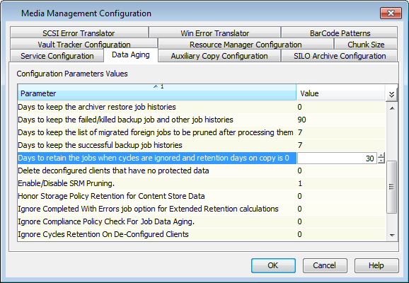

You can manually set the retention time for each command line job from the storage policy copy. The log backups will be aged according to the retention time set for its associated data backup job.
  1. From the CommCell Console, click the Storage tab.
  2. Click the Media Management icon.
  3. Click the Data Aging tab.
  4. Select the Days to retain the jobs when cycles are ignored and retention days on copy is 0 option and set the desired number of retention days.
  5. Click OK.

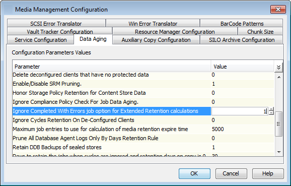

Data Aging Rules for Jobs Completed with Errors
Jobs that are completed with errors are not treated as a valid full backup job and hence are pruned based on basic retention rules. However, if you require to apply extended retention rules to these jobs, you can exclude the jobs that completed with errors during extended retention calculations.
  4. Change the value for the Ignore Completed With Errors job option for Extended Retention calculations option from 1 to 0.
  5. Click OK.
