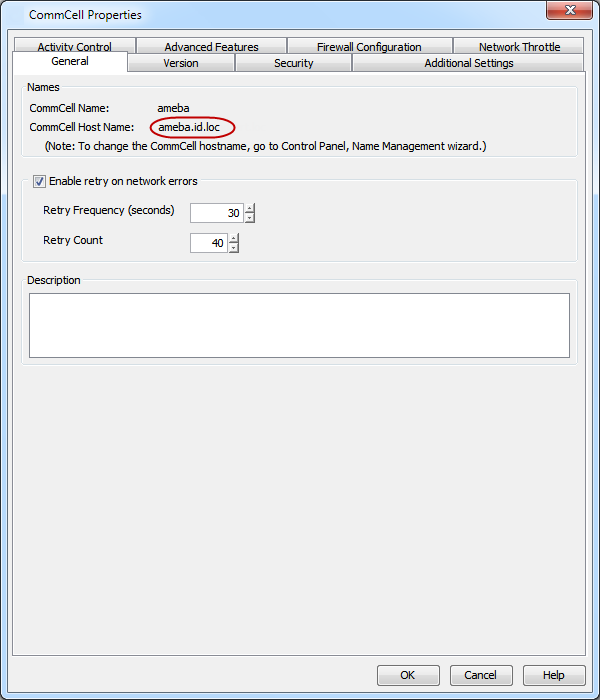

    Check the configuration in the CommCell Console for the CommServe, MediaAgent and the Client with issues. Different phases of the backup or restore operations require reviewing different communications paths. Also, check the registry entries on the CommServe, MediaAgent and the Client.
    The example below will cover the CommServe and the client computers.

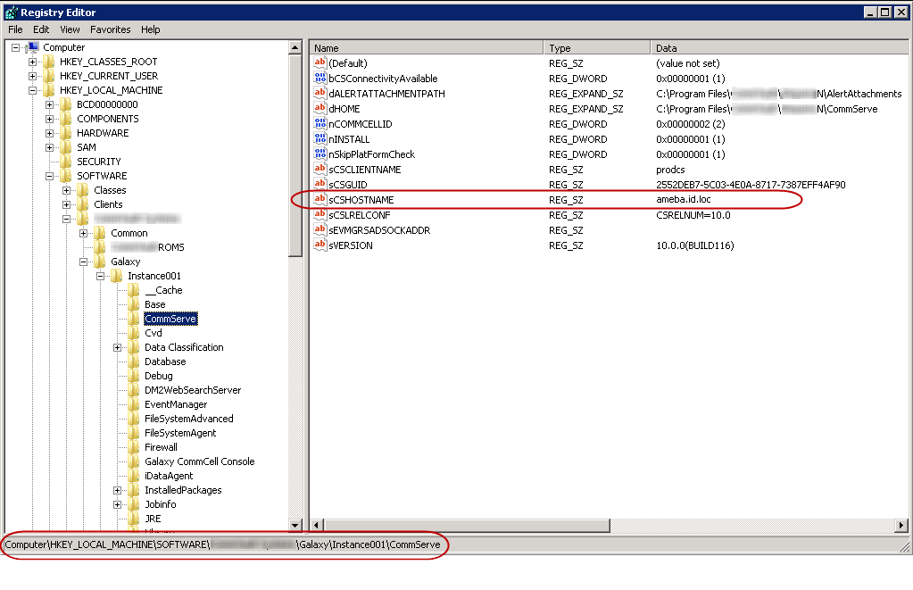

    1. From the CommCell Browser, right click the CommServe and click Properties. Check the CommCell Host Name.
      kb1
    2. From the CommCell Browser, right click the Client computer and click Properties. Check the host name and CommServe host name.

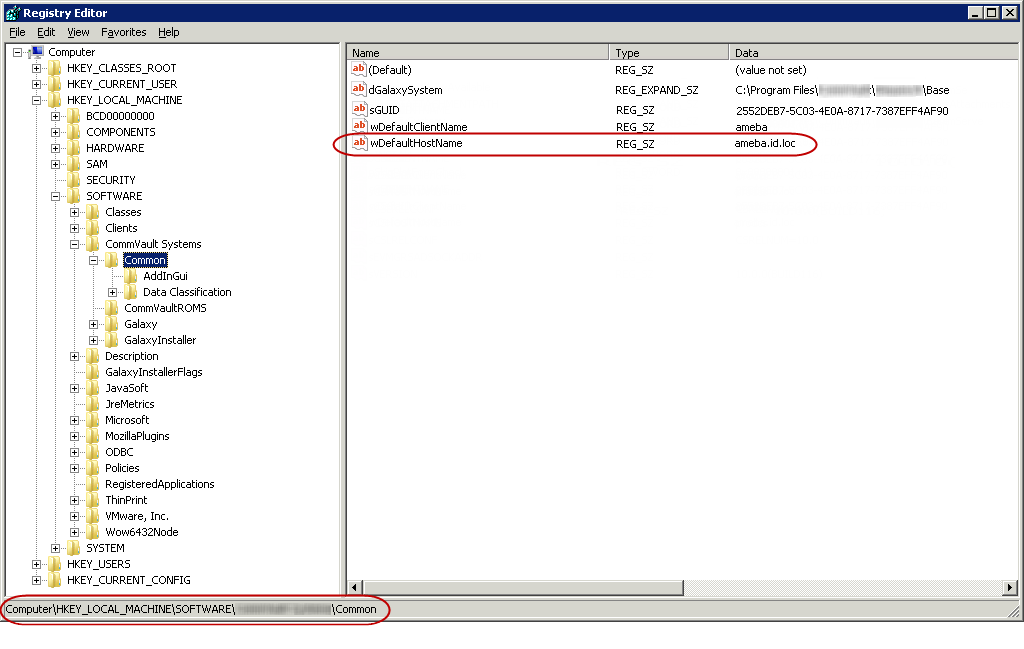

    3. The registry on the CommServe (CS) will have two locations that show the CS Host Name when it also has a Client (CL) installed.
      For the CommServe Name used by the Clients other then the CommServe Client the registry entry for sCSHOSTNAME is located under \HKLM\Software\Commvault Systems\Galaxy\Instance001\CommServe
      kb3
      For the CommServe with a Client (CL) File System Agent installed, the name is hosted at this registry location.
      Registry entry for wDefaultHostName is located under \HKLM\Software\Commvault Systems\Common
      kb4

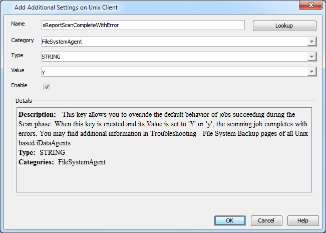

  8. Completed with one or more errors
By default the backup jobs from Linux File System iDataAgent complete without any error messages.
In the Scan phase files that cannot be accessed will be populated in scan_failures.cvf, in the following scenarios:
  • Stat failed.
  • If a file is deleted or renamed.
  • Unable to open a directory during scan
    To view the "Completed w/ one or more errors" message in the Job History in the Scan phase, follow the steps given below:
  • From the CommCell Browser, navigate to Client Computers.
  • Right-click the <Client> and click Properties.
  • Click Advanced and then click Additional Settings tab.
  • Click Add.
  • In the Name field, type sReportScanCompleteWithError.
  • In the Value field, type y or Y to enable the error message display or n or N to disable the error message display..

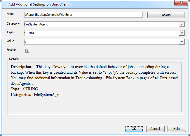

To view the "Completed w/ one or more errors" message in the Job History after a backup, follow the steps given below:
  4. Click Add.
  5. In the Name field, type sReportBackupCompleteWithError.
  6. In the Value field, type y or Y to enable the error message display or n or N to disable the error message display..
  7. Click OK.

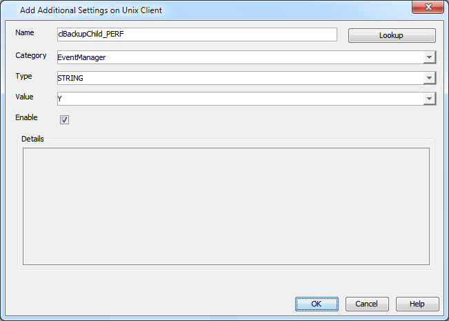

  • Displaying Performance Details of a Backup Job
    4. Click Add.
    5. In the Name field, type clBackupChild_PERF.
    6. In the Value field, type Y.
    7. Click OK.

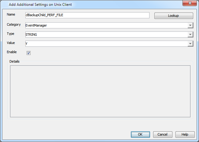

  • Displaying Performance Details for Each File in a Backup Job
    In addition to viewing the performance details for a backup job, you can also view the performance details of each file in the backup job. Note that the file names are not printed in the log.
    4. Click Add.
    5. In the Name field, type clBackupChild_PERF_FILE.
    7. Click OK.
      This additional setting should be used together with the clBackupChild_PERF additional setting.

    2. Check the sCSHOSTNAME additional setting.
      • Right-click the <Client> or <MediaAgent>, and then click Properties.
      • Click Add.
      • In the Name box, type sCSHOSTNAME.
      • The Category and Type fields are populated automatically.
      • In the Value box, if the current string value has _Disabled_ appended at the front of the string value, remove it to allow communication to the CommServe.
      • Click OK.
