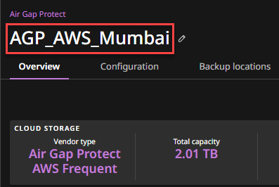

Replacing * in *.blob.core.windows.net
After you configure your Air Gap Protect storage on Azure Blob Storage, you can replace * in *.blob.core.windows.net with the specific storage account name. For example, in the following image, the name of the storage account is AGP_AWS_Mumbai:
agp-storage-account-name
