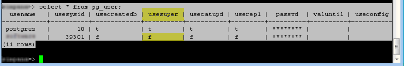

Use the following steps to add the superuser attribute to the user:
Once connected to PostgreSQL, run the following query to check if the usesuper attribute is incorrectly set:
select * from pg_user;
In the screenshot above, the commvault user has a f set against usesuper attribute. Instance creation using this user will therefore generate the above error.
When connected to PostgreSQL as superuser, run the following query to add the attribute:
PGSQL> ALTER USER username WITH superuser; -
Run the following query again to check if the attribute now shows a t against usesuper attribute.
