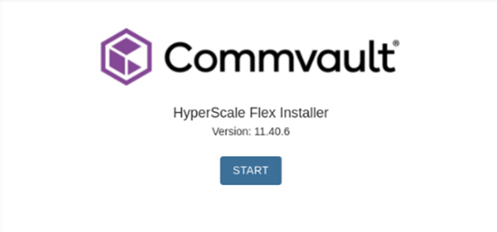

  1. Log on to the node as root user using the system console. (Do not use PuTTy / SSH to setup the nodes.)
    # hssetup
    The HyperScale Flex Installer page appears.
    hs_flex_install1
  3. Click Start.

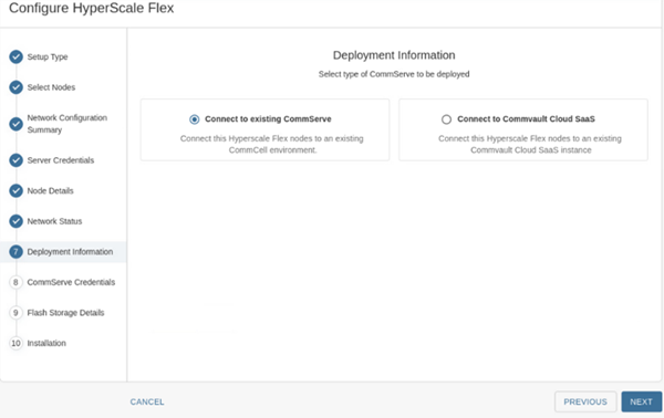

  16. Click Connect to existing CommServe, and then click NEXT.

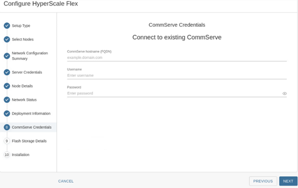

  17. To connect to the CommServe, provide the following details:
    2. In the Username and Password boxes, enter the CommCell user account credentials (not an Active Directory (AD) user account) to connect to the CommServe server, and then click Next.

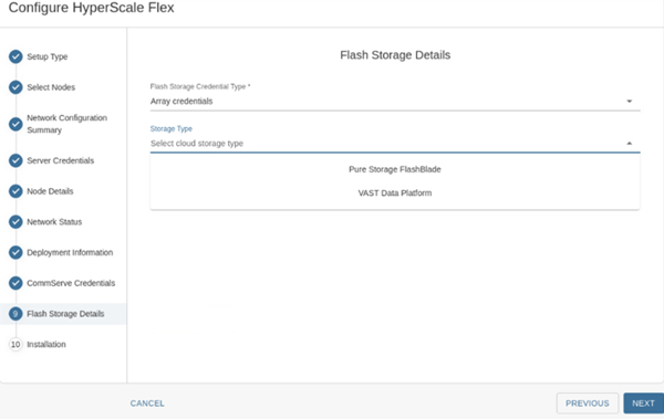

  18. For VAST Data Storage and Pure Storage, the page layout appears differently.

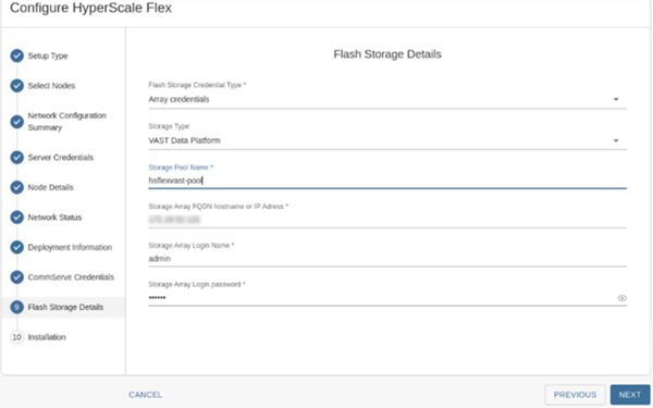

    • If you use VAST Data Storage, complete the following steps:
      1. From the Flash Storage Credential Type list, select Array credentials.
      2. From Storage Type list, select VAST Data Platform.
      3. In the Storage Pool Name box, type a name for the cloud storage pool.
      4. In the Storage Arry FQDN hostname or IP address, type the hostname of IP address of the cloud storage array.
      5. In the Storage Array Login Name box, type the user account to access the cloud storage array.
      6. In the Storage Array Login Password, enter the password for the cloud storage user account.
      7. Click NEXT.

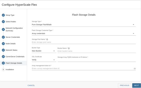

    • If you use Pure Storage, complete the following steps:
      1. From Storage Type list, select Pure Storage FlashBlade.
      2. From the Flash Storage Credential Type list, select Array credentials.
      4. In the Bucket Name box, enter the bucket name.
      5. In the Storage Array FQDN hostname or IP address, type the hostname of IP address of the cloud storage array.
      6. In the Array Management Token Id box, enter the token ID to access the cloud storage.
      7. Click NEXT.
