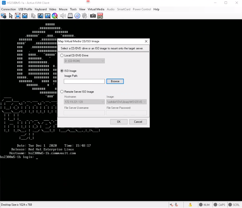

Access the node using the KVM management console in your environment.
Map the downloaded ISO image as a virtual media from the KVM Management console.
Click here to view a sample image.
Reboot the node using the virtual media as follows.

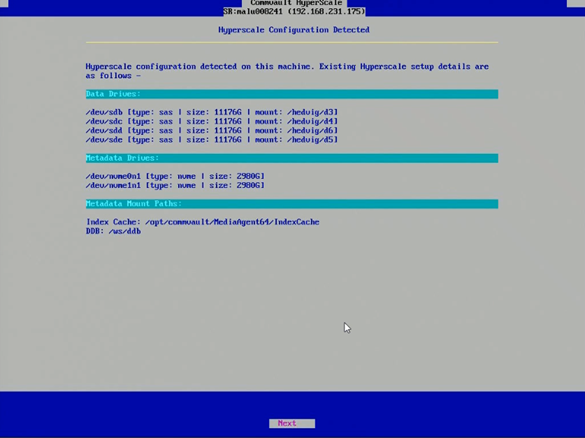

If you are using a node that has an existing HyperScale configuration, the HyperScale Configuration Detected screen is displayed.
If you are using a new node, this screen will not appear.
Choose Next.
The Preserve Data screen is displayed.
Select the Reinitialize Drives option and then click Next.

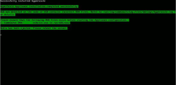

The installation process will be started. This process will take some time to complete.
The following message is displayed when the installation is complete.
Reboot the node.
