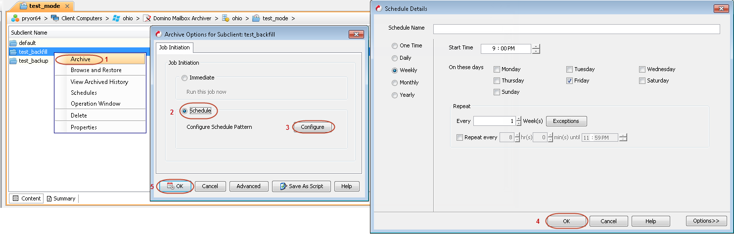

Schedule an Archive Job
To schedule an archive job, follow the steps:
  1. From the CommCell Console, navigate to <Client> | Domino Mailbox Archiver
  2. Right-click the Subclient and click Archive
  3. Click Schedule
  4. Click Configure
  5. Select Schedule Options. For example:
    Click Weekly
    Check the days you want the run the archive job
    Change the Start Time to 9:00 PM
    Click OK to close the Schedule Details dialog box
    Click OK to close the Archive Options dialog box
The archive job will execute as per the schedule.

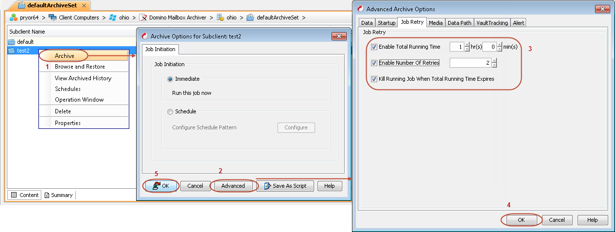

  1. From the CommCell Console, navigate to <Client> | Domino Mailbox Archiver.
  2. Right-click the Subclient and select Archive.
  3. Click Advanced.
  4. In the Advanced Archive Options dialog box, click the Job Retry tab.
  5. Select Enable Total Running Time and specify the maximum elapsed time before a job can be restarted or killed.
    Select Kill Running Jobs When Total Running Time Expires to kill the job after reaching the maximum elapsed time.
  6. Select Enable Number Of Retries and specify the number of retries.
  7. Click OK.
