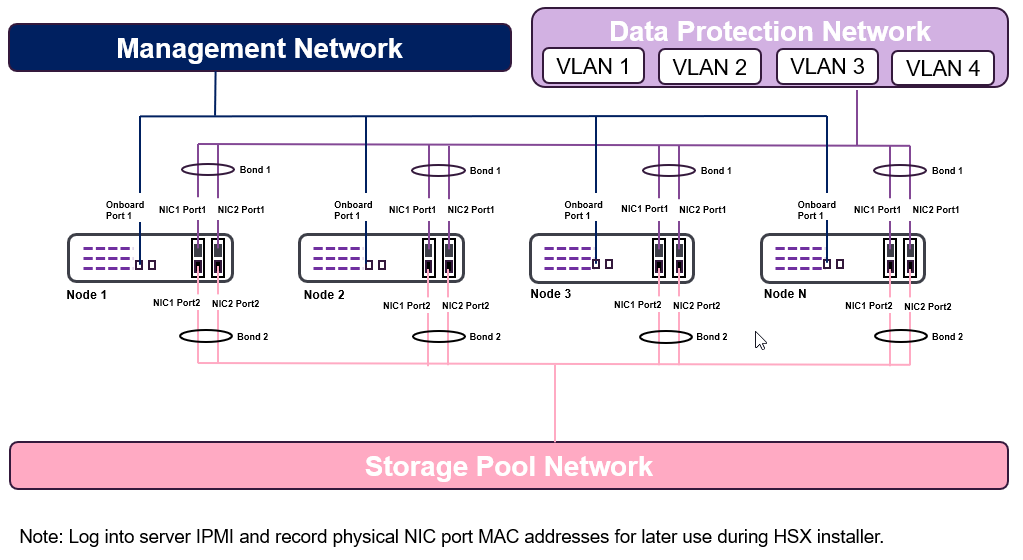

This topology combines bonded VLAN topology with the 1 GbE management interface.
This allows multiple tagged VLANs to connect to the appliance using the bonded data protection interface. This also allows connection to multiple non-routable networks used to avoid sending backup traffic through a router or firewall.
Management interface can be used to route management traffic, which leverages one of the built-in 1 GbE copper interfaces for management traffic . Management interface will require additional cabling.
2 - 10 GbE bonded ports for data protection which will connect to multiple tagged VLANs to transfer data to and from the clients being protected and connect to the CommServe server. This will include connections to:
2 or more VLAN IDs
2 or more IP addresses based on the number of VLANs
One of the VLANs must remain routable to connect to the CommServe server.
2- 10 GbE bonded ports for storage pool which is a dedicated private network, used for communication and replication between the HyperScale nodes.
1 - 1 GbE port for management network, which is used exclusively for all management related communication, such as communicating with the CommServe server, accessing the DNS server, etc.
Management ports cannot be configured with bonding.
This is an extreme scenario where multiple VLANs connect directly to the Commvault Grid Reference Architecture nodes over a single physical connection. This is typically used to connect directly to different networks to avoid traversing routers or firewalls that can become a bottleneck, or to connect to isolated networks. This can be combined with the bonded configurations to provide redundancy using either the Active-Backup bonding or the Link Aggregation Control Protocol (LACP). This can also be used with a multi-switch link aggregation protocol such as Virtual Port Channel (VPC), MLAG, or MC-LAG to provide switch level redundancy. Management network can be added for additional flexibility.
Each pair will be bonded on the node, so it is treated as one logical connection. If a node encounters a cable, SFP, or network card failures, the node remains operational without any user intervention. This can optionally be setup to connect to 2 switches to provide switch level redundancy.
Active-Backup and Link Aggregation Control Protocol (LACP) are the supported bonding modes.
LACP requires the switch(s) to support it as well. When using LACP, each pair of ports should be configured as an active port-channel, and not configured to negotiate the aggregation protocol.
Network Requirements
2 - 10 GbE bonded ports connected to the VLAN IP addresses for each of the VLANs used for data protection.
Out of the available VLANs, one network should be routable and the other network(s) must be non-routable. The routable network will be used for CommServe server registration, in addition to data protection operations. All the other VLANs will be used exclusively for data protection operations.
2 - 10 GbE bonded port for the storage pool which is a dedicated private network, used for communication and replication between the HyperScale nodes. This requires a corresponding IP address for the storage pool network.
1 – 1 GbE port for the management network, which is connected to a routable network with DNS access. This requires a corresponding IP address for the management network.
Data Protection, storage pool and management networks MUST be on separate subnets.
