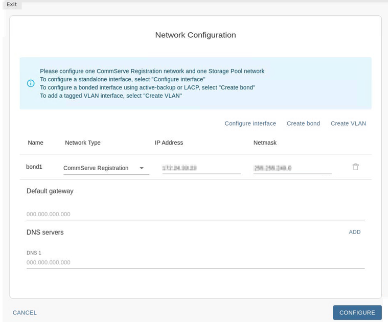

Configure the data protection interface (bonded) as follows:
Click Create bond.
From the Interfaces list, select the 2 interfaces that will form the data protection bond. (For example, enpsf3 and enpsf5)
From Bonding mode list, select either active-backup (Mode 1) or LACP (Mode 4).
Click CREATE.
From the Network Type list, select CommServe Registration.
Add the IP Address and Netmask in the respective boxes.

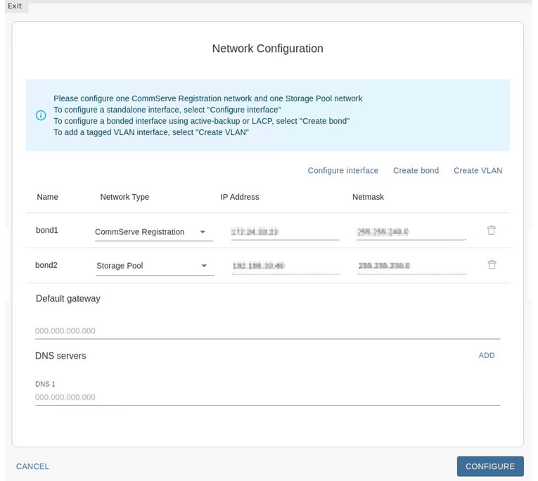

Configure the storage pool interface (bonded) as follows:
Click Create bond.
From the Interfaces list, select the 2 interfaces that will form the storage pool bond. (For example, enpsf4 and enpsf6 .)
Click CREATE.
From the Network Type list, select Storage Pool. This interface will be used exclusively for communication and replication between the HyperScale nodes.

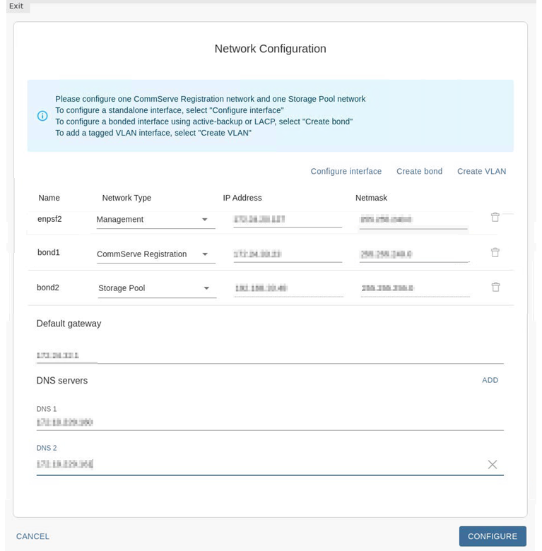

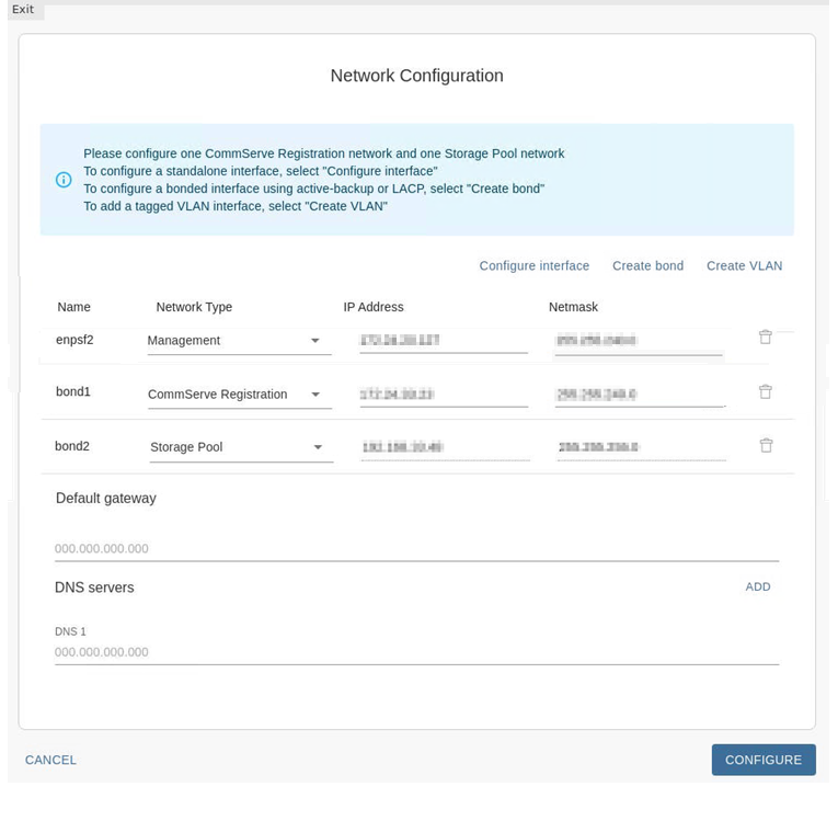

Configure the management interface as follows:
Click Configure interface.
From the Interfaces list, select one of the management interfaces. (For example, enpsf1 or enpsf2.)
Click CREATE.
From the Network Type list, select Management. This interface will be used for all management related communication, such as connecting to the CommServe server, accessing the DNS server, etc.
Configure the DNS server(s) as follows:
In the Default Gateway box, add the IP address associated with the default gateway.
In the DNS Servers box, add the IP address associated with the DNS Server.
Click CONFIGURE.

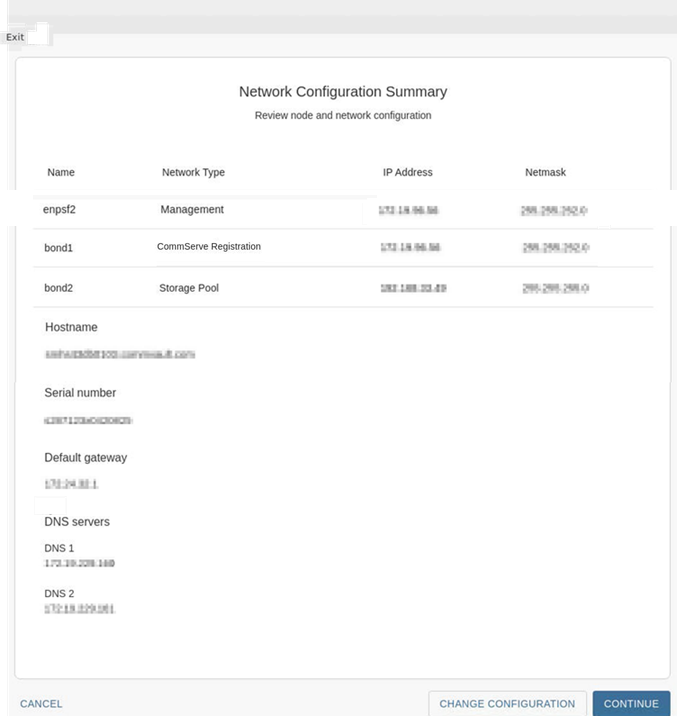

Verify the network configuration by clicking the tab associated with each node. Ensure that the nodes are accurately configured and then click NEXT.
IP address and netmask for the data protection interface is accurate.
IP address and netmask for the storage pool interface is accurate.
IP address and netmask for the management interface is accurate.
Hostname and serial number associated with the node is accurate.
Default gateway and DNS servers are accurately configured.

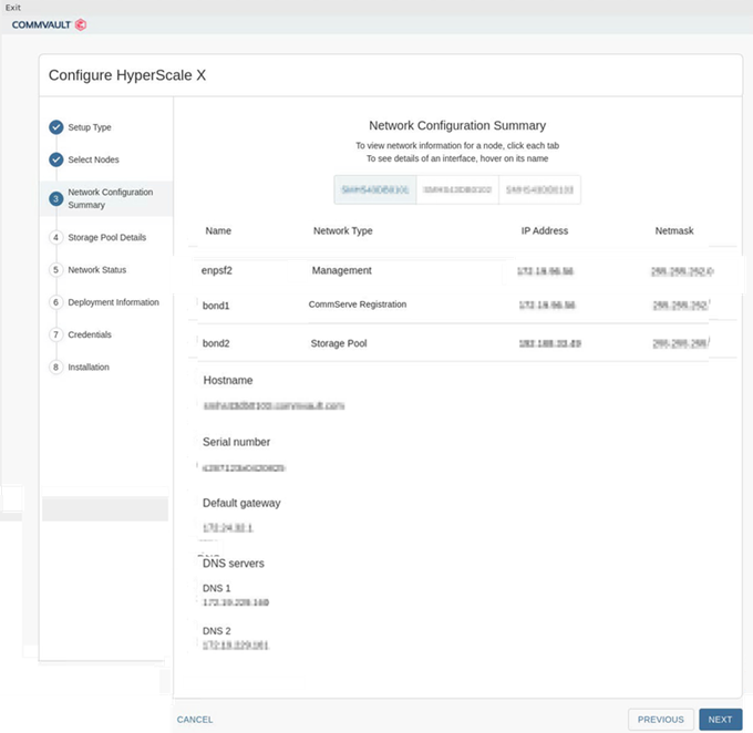

Verify the summary for each node by clicking the tabs associated with each node. Ensure that the nodes are accurately configured and then click NEXT.
IP address and netmask for the data protection interface accurate.
All nodes have identical information for the default gateway and DNS servers.
