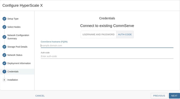

  15. Choose one of the following options to connect to the CommServe:
    2. To connect using an authorization code, click Auth-Code, and then provide the following details. Make sure that you enable installation using authorization code for the CommCell. For more information, see User Administration and Security.
        Connecting to an Existing CommServe Server (1) The software validates the information and will start the installation process. This process may take some time (approximately 45 minutes) to complete. You can monitor the progress using the progress bar.
