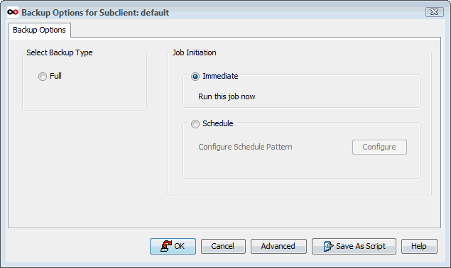

  1. From the CommCell Browser, navigate to <Client> | Notes Database | Instance.
  2. Right click the <Subclient> and click Backup.
  3. Select Full as backup type and Immediate to run the job immediately.
  4. Click OK.
    You can track the progress of the job from the Job Controller or Event Viewer window. When the backup has completed, the Job Controller displays Completed.

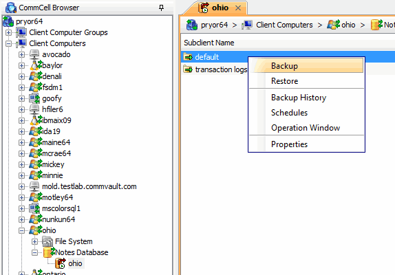

  1. From the CommCell Console, navigate to Client Computers | Notes Database | Instance.
    Right-click the Subclient and click Backup.
    backup_basic01

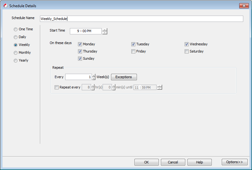

  2. Click Schedule to schedule the backup for a specific time.
    Click Configure to set the schedule for the backup job. The Schedule Details dialog displays.
    backup_basic02 - snap_backupklzzwxh:0245otus_notesklzzwxh:0246ackup_basic02.png
  3. Select the appropriate scheduling options. For example:
    • Click Weekly.
    • Check the days you want the run the backup job.
    • Click OK to close the Backup Options dialog
