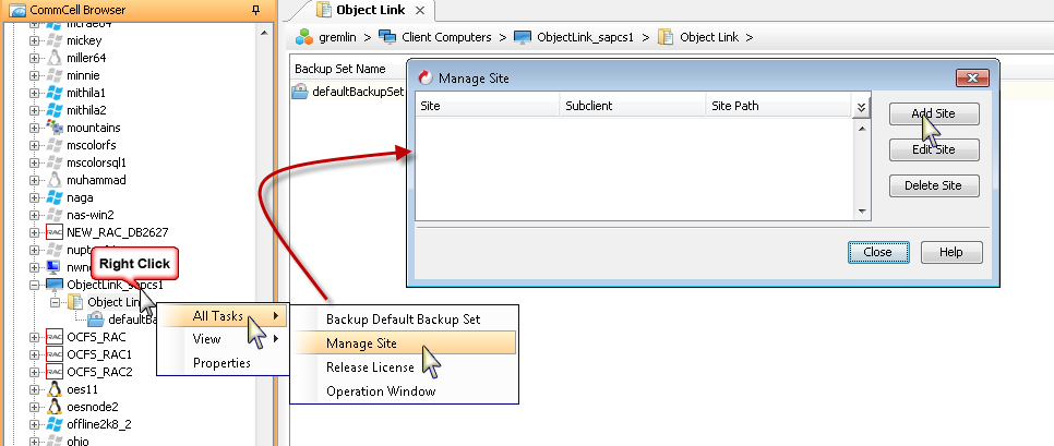

Creating a Site
  1. From the CommCell Browser, expand Client Computers >SAP Archive Link Client .
  2. Right-click the Agent andpoint to All Tasks > Manage Site
    The Manage Site dialog box appears with the following information:
    • Site: Displays the name of the site
    • Subclient: Displays the name of the subclient associated with this site
    • Site Path: Displays the URL or path to the site
    • Click the Add Site button to define a content repository.
    define_site_3
